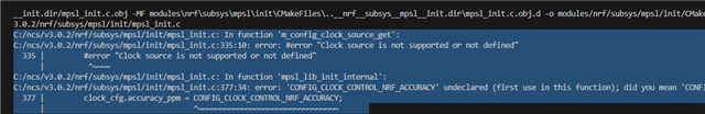

My routine code has not been modified at all
Board select nrf54l15dk/nrf54l15/cap/ns

Hi
Which SDK are you using? I also presume there is an typo in the board name right?
Regards
Runar
I have resolved the issue. As the SDK was missing during download, I used my colleague's SDK for COPY replacement and it worked fine
