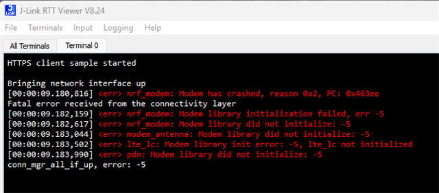

Testing a new nRF9151 device using a project derived from the Nordic "HTTPS client" sample project. We are experiencing a "Modem has crashed" event intermittently when running our code. To verify the source was not our derived source code or our device; I reverted to the original Nordic sample code without any alteration and switched hardware to the nRF9151 DK.
The build is using the following Extra Kconfig fragments: overlay-tfm-nrf91.conf, overlay-pdn-nrf91-ipv4.conf (Nordic sample files) and overlay-segger-rtt.conf (LooUQ provided/attached).
The build has debugging enabled (-Og).
The crash error happens about every 3 or 4 executions of the code.
Is this a known issue? Workarounds?

    To narrow this down further, could you clarify the following:
    • Is it true that this issue occurs on both your custom board and the nRF9151DK?
    • Does the issue occur when you build without debugging options?
    • Are you able to run the HTTPS client sample as-is, without any overlay files?

  • Update... I have the UART working now, so I can pull RTT and debugging out of the equation. I am testing only with the 9151DK right now and do not see the problem in about 10 test runs with the sample "as-is".
    I understand the variables to adjust: debugging and overlays. You can either close the ticket and I can re-open if I have a more reproduceable pattern. Or leave it open for 7-10 days. I will get back to it, but it will be at least the end of the week.
