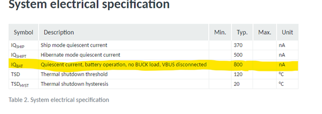

What is the quiescent current of the PM1300 when it is not in SHIP or hibernate mode, but when it is "alive" and configured and running off the VBAT terminal, ignoring any external current drains such as IO, VSYS, the LDO or switcher outputs.

You can find this under the electrical specifications in our documentation. See the reference here and the screenshot below.

Thanks, I saw that, is it the same for VBUS under the same conditions?
Quiescent current on VBUS is not the same as on VBAT. When powered from VBUS with no load and the charger idle, the current is about 1.8 mA. If VBUS suspend mode is not enabled, it increases to around 2.5 mA (see Isusp in the documentation).
