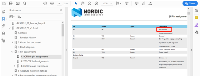

The nRF52832 PS mentions that the pin 44 of nRF52832 QFN48 require no connect. What problem if pin 44 of nRF52832 QFN48 is grounded? Many thanks.

This pin isn't connected internally, so it shouldn't be any problem grounding it.
