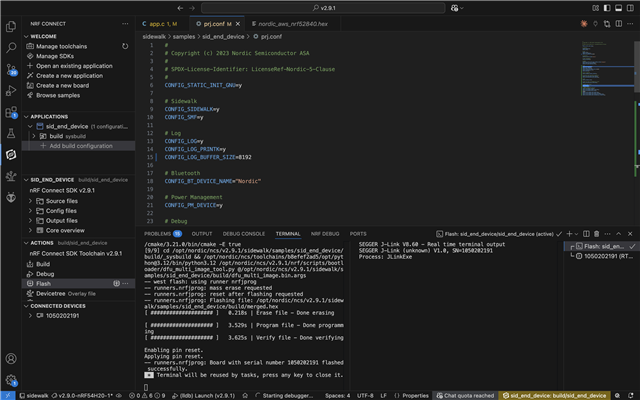

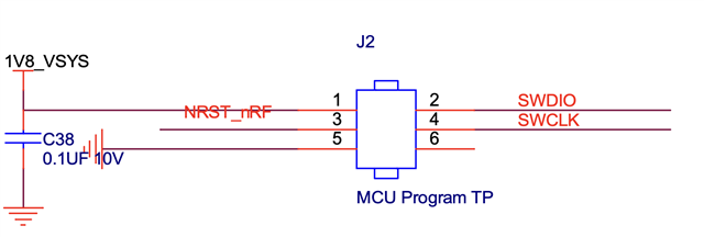

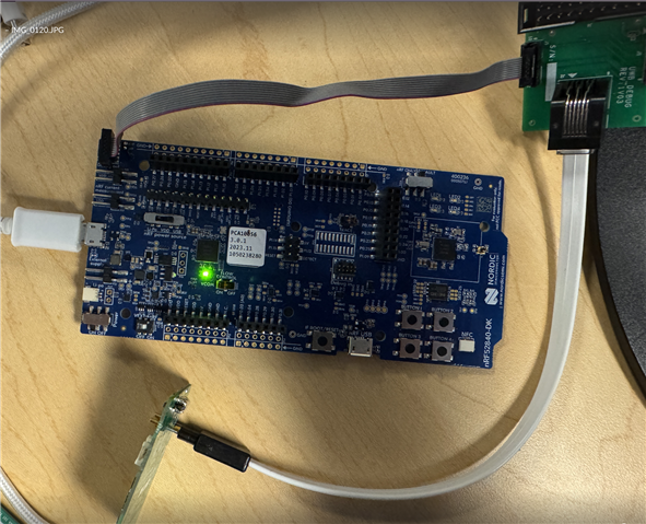

Hi everyone ! I am having trouble trying to flash a custom firmware to a nrf52840 board connected to another custom board using P19 debug out I am flashing the code directly using the IMCU USB port on the nrf52840 board. SB19 is soldered to the on-board J-Link to route the signal to the Debug OUT port Hope you guys can help me solve this problem as it has taken me too long ! Thanks averyone, have a nice day !

-- west flash: using runner nrfjprog
-- runners.nrfjprog: reset after flashing requested
-- runners.nrfjprog: Flashing file: /opt/nordic/ncs/v2.9.1/sidewalk/samples/sid_end_device/build_lora/merged.hex
[error] [ Client] - Encountered error -102: Command read_device_info executed for 132 milliseconds with result -102
[error] [ Worker] - An unknown error.
[error] [ Client] - Encountered error -102: Command read_memory_descriptors executed for 25 milliseconds with result -102
Failed to read device memories.
ERROR: JLinkARM DLL reported an error. Try again. If error condition
ERROR: persists, run the same command again with argument --log, contact Nordic
ERROR: Semiconductor and provide the generated log.log file to them.
NOTE: For additional output, try running again with logging enabled (--log).
NOTE: Any generated log error messages will be displayed.
FATAL ERROR: command exited with status 33: nrfjprog --program /opt/nordic/ncs/v2.9.1/sidewalk/samples/sid_end_device/build_lora/merged.hex --sectoranduicrerase --verify -f NRF52 --snr 1050202191
