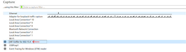

I have been trying to get my brand new nRF52840 Dongle working as an 802.15.4/Zigbee sniffer, but I am not able to capture any packets, even though the interface is detected and responsive. Here are the details of what I have done and tested:

Wireshark behavior:
  • When running Wireshark with sudo (as mentioned in GitHub issue #68), the interface appears, and I can start a capture.
  • Without sudo, the interface does not appear in Wireshark.

  • Wireshark version: 4.4.8 (v4.4.8-0-g0d289c003bfb)
  • Tried reconnecting/replugging the dongle multiple times on both OSes.
  • Same result every time: interface visible, capture starts, but no packets arrive.
