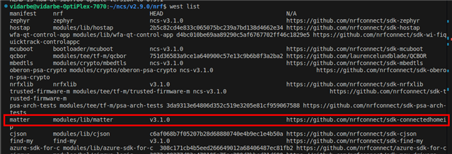

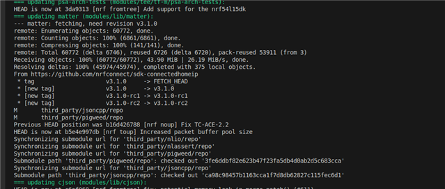

The following steps were taken to update from 3.0.2 to 3.1.0
git fetch origin
git checkout v3.1.0
west update
The full build log is attached. I have done a pristine build and deleted the build directory with no success.

Any assistance that can help get me back on track is greatly appreciated.
    Please check the output of the "west update" command to confirm that the Matter repo got updated to v3.1.0. Note that the update command will continue updating the other repositories even if a git or connectivity error occurs while updating the Matter repository.
    From West update when I try the same:
    Matter revision as specified in the nrf manifest:
    Vidar
  • Hi Vidar,
    West list does show matter at v3.1.0. To be thorough, I checked both in a terminal within VSCode and a terminal in the nrf directory of the SDK.
    To rule out any issues with my existing SDK directory, I have pulled a fresh copy of the SDK using the following steps:

    Update:
    I installed the toolchain and sdk through VSCode and was able to build the project. While this works, I am curious to know how to get my manually installed SDK and toolchain working as before.
    Update 2:
    After further experimentation I think I am getting closer to the issue. Using SDK v3.1.0, manually installed, with toolchain v3.1.0, I can build my project. When I switch to the Zephyr toolchain, either 0.17.0 or 0.17.4, I can no longer build. Is this expected behavior?
    Thank you for the updates. I see the problem now which is that this new python dependency got introduced in SDK v3.1.0: https://github.com/nrfconnect/sdk-nrf/commit/8aa1591091e95c0d30db946732c02faa2643ad40. Unlike the Zephyr SDK, the NCS toolchain includes Python and the required modules. Otherwise, you need to install these dependencies manually.
    If you have nrfutil installed, you can use the following command if you wish to use the NCS toolchain outside VS code:
    $ source <(nrfutil sdk-manager toolchain env --ncs-version v3.1.0 --as-script)
  • Thank you for the help Vidar, I was able to get everything working once I installed the missing dependencies.
