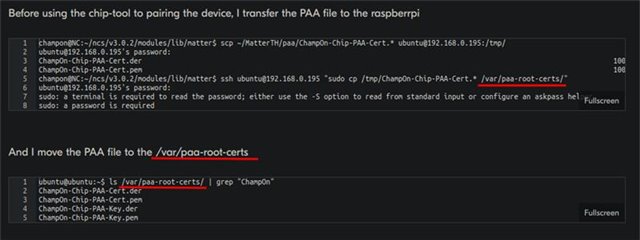

Before using the chip-tool to pairing the device, I transfer the PAA file to the raspberrpi
champon@NC:~/ncs/v3.0.2/modules/lib/matter$ scp ~/MatterTH/paa/ChampOn-Chip-PAA-Cert.* [email protected]:/tmp/
[email protected]'s password:
ChampOn-Chip-PAA-Cert.der                                                                                                                  100%  448    91.1KB/s   00:00
ChampOn-Chip-PAA-Cert.pem                                                                                                                  100%  664   108.6KB/s   00:00
champon@NC:~/ncs/v3.0.2/modules/lib/matter$ ssh [email protected] "sudo cp /tmp/ChampOn-Chip-PAA-Cert.* /var/paa-root-certs/"
sudo: a terminal is required to read the password; either use the -S option to read from standard input or configure an askpass helper
sudo: a password is required
And I move the PAA file to the /var/paa-root-certs
ubuntu@ubuntu:~$ ls /var/paa-root-certs/ | grep "ChampOn"
ChampOn-Chip-PAA-Key.der
ChampOn-Chip-PAA-Key.pem

    To me it looks like you've followed the guides properly, with one difference in that you've placed the certificates to /var/paa-root-certs on the RPi. This shouldn't be an issue if you also adjust the upcoming chip-tool command that you use, i.e where you specify  /paa_roots/ as the path to the certificates.
    Could you verify if you give the correct path to --paa-trust-store-path since the log does not completely correspond with where you've placed the certificates?
    Andreas
  • Hi AHaug,
    ubuntu@ubuntu:~$ ls /var/paa-root-certs/ | grep  ChampOn
    ubuntu@ubuntu:~$ fish
    Welcome to fish, the friendly interactive shell
    Type help for instructions on how to use fish
    ubuntu@ubuntu ~> sudo chip-tool pairing ble-thread 0x11820 hex:0e08000000000001000035060004001fffe00708fd583913eac813490410a9f333e7e2b8af3f4dab38d30350c01c0c0402a0f7f8000300001901025b3502085b35dead5b35beef030435623335051000112233445566778899aabbccddeeff 17318858 1731 --paa-trust-store-path /var/paa-root-certs/
    [sudo] password for ubuntu:
    [1755592965.361] [16192:16192] [DL] ChipLinuxStorage::Init: Using KVS config file: /root/snap/chip-tool/common/chip_tool_kvs
    [1755592965.363] [16192:16192] [DL] ChipLinuxStorage::Init: Attempt to re-initialize with KVS config file: /tmp/chip_kvs, IGNORING.

    [1755592965.419] [16192:16192] [TOO] No PAAs found in path: /var/paa-root-certs/
    [1755592965.419] [16192:16192] [TOO] Please specify a valid path containing trusted PAA certificates using the argument [--paa-trust-store-path paa/file/path] or environment variable [CHIPTOOL_PAA_TRUST_STORE_PATH=paa/file/path]
    [1755592965.419] [16192:16192] [TOO] Run command failure: ../examples/chip-tool/commands/common/CHIPCommand.cpp:87: CHIP Error 0x0000002F: Invalid argument

    fish: Job 1, 'sudo chip-tool pairing ble-thre…' terminated by signal SIGABRT (Abort)
    ubuntu@ubuntu ~ [SIGABRT]> exit
    ubuntu@ubuntu:~$ sudo chip-tool pairing ble-thread 0x11820 hex:0e08000000000001000035060004001fffe00708fd583913eac813490410a9f333e7e2b8af3f4dab38d30350c01c0c0402a0f7f8000300001901025b3502085b35dead5b35beef030435623335051000112233445566778899aabbccddeeff 17318858 1731 --paa-trust-store-path /var/paa-root-certs/
    [1755593182.133] [16250:16250] [DL] ChipLinuxStorage::Init: Using KVS config file: /root/snap/chip-tool/common/chip_tool_kvs
    [1755593182.134] [16250:16250] [DL] ChipLinuxStorage::Init: Attempt to re-initialize with KVS config file: /tmp/chip_kvs, IGNORING.
    [1755593182.140] [16250:16250] [DL] ChipLinuxStorage::Init: Using KVS config file: /tmp/chip_factory.ini
    [1755593182.140] [16250:16250] [DL] ChipLinuxStorage::Init: Using KVS config file: /tmp/chip_config.ini
    [1755593182.140] [16250:16250] [DL] ChipLinuxStorage::Init: Using KVS config file: /tmp/chip_counters.ini
    [1755593182.148] [16250:16250] [DL] Wrote settings to /tmp/chip_counters.ini
    [1755593182.148] [16250:16250] [DL] NVS set: chip-counters/reboot-count = 3 (0x3)
    [1755593182.150] [16250:16250] [DL] Got Ethernet interface: br-b5265faf06c2
    [1755593182.151] [16250:16250] [DL] Found the primary Ethernet interface:br-b5265faf06c2
    [1755593182.151] [16250:16250] [DL] Got WiFi interface: wlan0
    [1755593182.154] [16250:16250] [DL] Found the primary WiFi interface:wlan0
    [1755593182.154] [16250:16250] [PAF] WiFiPAF: WiFiPAFLayer::Init()
    [1755593182.155] [16250:16250] [IN] UDP::Init bind&listen port=0
    [1755593182.155] [16250:16250] [IN] UDP::Init bound to port=44046
    [1755593182.155] [16250:16250] [IN] UDP::Init bound to port=40904
    [1755593182.155] [16250:16250] [IN] BLEBase::Init - setting/overriding transport
    [1755593182.155] [16250:16250] [IN] WiFiPAFBase::Init - setting/overriding transport
    [1755593182.155] [16250:16250] [IN] TransportMgr initialized
    [1755593182.155] [16250:16250] [FP] Initializing FabricTable from persistent storage
    [1755593182.155] [16250:16250] [TS] Last Known Good Time: 2023-10-14T01:16:48
    [1755593182.157] [16250:16250] [FP] Fabric index 0x1 was retrieved from storage. Compressed FabricId 0xB3DAE46C9A64DBAF, FabricId 0x0000000000000001, NodeId 0x000000000001B669, VendorId 0xFFF1
    [1755593182.160] [16250:16250] [DMG] Ember attribute persistence requires setting up
    [1755593182.160] [16250:16250] [ZCL] Using ZAP configuration...
    [1755593182.195] [16250:16250] [CTL] System State Initialized...
    [1755593182.195] [16250:16250] [TOO] No PAAs found in path: /var/paa-root-certs/
    [1755593182.195] [16250:16250] [TOO] Please specify a valid path containing trusted PAA certificates using the argument [--paa-trust-store-path paa/file/path] or environment variable [CHIPTOOL_PAA_TRUST_STORE_PATH=paa/file/path]
    [1755593182.195] [16250:16250] [TOO] Run command failure: ../examples/chip-tool/commands/common/CHIPCommand.cpp:87: CHIP Error 0x0000002F: Invalid argument
    [1755593182.220] [16250:16250] [SPT] HeapObjectPool: 1 allocated
    [1755593182.220] [16250:16250] [SPT] VerifyOrDie failure at src/lib/support/Pool.h:405: Allocated() == 0
    Aborted
    ubuntu@ubuntu:~$ echo $CHIPTOOL_PAA_TRUST_STORE_PATH
    ubuntu@ubuntu:~$ ls -la /var/paa-root-certs/
    total 948
    drwxr-xr-x  2 ubuntu ubuntu 24576 Aug 18 16:27 .
    drwxr-xr-x 16 root   root    4096 Jun  6 11:17 ..
    -rw-rw-r--  1 ubuntu ubuntu   405 Aug 18 16:25 ChampOn-Chip-PAA-Cert.der
    -rw-rw-r--  1 ubuntu ubuntu   603 Aug 18 16:27 ChampOn-Chip-PAA-Cert.pem
    -rw-rw-r--  1 ubuntu ubuntu   449 Aug 15 12:01 Chip-Test-PAA-FFF1-Cert.der
    -rw-rw-r--  1 ubuntu ubuntu   664 Aug 15 12:01 Chip-Test-PAA-FFF1-Cert.pem
    -rw-rw-r--  1 ubuntu ubuntu   405 Aug 15 12:01 Chip-Test-PAA-NoVID-Cert.der
    -rw-rw-r--  1 ubuntu ubuntu   603 Aug 15 12:01 Chip-Test-PAA-NoVID-Cert.pem
    -rw-rw-r--  1 ubuntu ubuntu   458 Aug 15 12:01 dcld_mirror_CN_70mai_Matter_PAA_vid_0x140B.der
    -rw-rw-r--  1 ubuntu ubuntu   675 Aug 15 12:01 dcld_mirror_CN_70mai_Matter_PAA_vid_0x140B.pem
    -rw-rw-r--  1 ubuntu ubuntu   447 Aug 15 12:01 dcld_mirror_CN_AB_Test_PAA_vid_0x137B.der
    -rw-rw-r--  1 ubuntu ubuntu   659 Aug 15 12:01 dcld_mirror_CN_AB_Test_PAA_vid_0x137B.pem
    -rw-rw-r--  1 ubuntu ubuntu   440 Aug 15 12:01 dcld_mirror_CN_ACK_PAA_vid_0x137A.der
    -rw-rw-r--  1 ubuntu ubuntu   651 Aug 15 12:01 dcld_mirror_CN_ACK_PAA_vid_0x137A.pem
    -rw-rw-r--  1 ubuntu ubuntu   447 Aug 15 12:01 dcld_mirror_CN_ACK_Test_PAA_vid_0x137A.der
    -rw-rw-r--  1 ubuntu ubuntu   659 Aug 15 12:01 dcld_mirror_CN_ACK_Test_PAA_vid_0x137A.pem
    -rw-rw-r--  1 ubuntu ubuntu   471 Aug 15 12:01 dcld_mirror_CN_Anker_Innovations_Matter_PAA_vid_0x1533.der
    -rw-rw-r--  1 ubuntu ubuntu   691 Aug 15 12:01 dcld_mirror_CN_Anker_Innovations_Matter_PAA_vid_0x1533.pem
    -rw-rw-r--  1 ubuntu ubuntu   505 Aug 15 12:01 dcld_mirror_CN_Aqara_Matter_PAA_01_O_Lumi_United_Technology_Co__Ltd.der
    -rw-rw-r--  1 ubuntu ubuntu   740 Aug 15 12:01 dcld_mirror_CN_Aqara_Matter_PAA_01_O_Lumi_United_Technology_Co__Ltd.pem
    -rw-rw-r--  1 ubuntu ubuntu   446 Aug 15 12:01 dcld_mirror_CN_Basics_PAA_vid_0x137B.der
    -rw-rw-r--  1 ubuntu ubuntu   659 Aug 15 12:01 dcld_mirror_CN_Basics_PAA_vid_0x137B.pem
    -rw-rw-r--  1 ubuntu ubuntu   466 Aug 15 12:01 dcld_mirror_CN_Beken_Development_PAA_01_vid_0x1342.der
    -rw-rw-r--  1 ubuntu ubuntu   687 Aug 15 12:01 dcld_mirror_CN_Beken_Development_PAA_01_vid_0x1342.pem
    -rw-rw-r--  1 ubuntu ubuntu   531 Aug 15 12:01 dcld_mirror_CN_Beken_PAA_01_O_BEKEN_CORPORATION_C_CN_vid_0x1342.der
    -rw-rw-r--  1 ubuntu ubuntu   773 Aug 15 12:01 dcld_mirror_CN_Beken_PAA_01_O_BEKEN_CORPORATION_C_CN_vid_0x1342.pem
    -rw-rw-r--  1 ubuntu ubuntu   469 Aug 15 12:01 dcld_mirror_CN_BouffaloLab_Matter_PAA_vid_0x130D.der
    -rw-rw-r--  1 ubuntu ubuntu   691 Aug 15 12:01 dcld_mirror_CN_BouffaloLab_Matter_PAA_vid_0x130D.pem
    -rw-rw-r--  1 ubuntu ubuntu   479 Aug 15 12:01 dcld_mirror_CN_BouffaloLab_Matter_Test_PAA_vid_0x130D.der
    -rw-rw-r--  1 ubuntu ubuntu   703 Aug 15 12:01 dcld_mirror_CN_BouffaloLab_Matter_Test_PAA_vid_0x130D.pem
    -rw-rw-r--  1 ubuntu ubuntu   462 Aug 15 12:01 dcld_mirror_CN_CommScope_Technologies_LLC_Matter_PAA.der
    -rw-rw-r--  1 ubuntu ubuntu   679 Aug 15 12:01 dcld_mirror_CN_CommScope_Technologies_LLC_Matter_PAA.pem
    -rw-rw-r--  1 ubuntu ubuntu   467 Aug 15 12:01 dcld_mirror_CN_CoolKit_Matter_PAA_test_vid_0x1286.der
    -rw-rw-r--  1 ubuntu ubuntu   687 Aug 15 12:01 dcld_mirror_CN_CoolKit_Matter_PAA_test_vid_0x1286.pem
    -rw-rw-r--  1 ubuntu ubuntu   462 Aug 15 12:01 dcld_mirror_CN_Coolkit_Matter_PAA_vid_0x1286.der
    -rw-rw-r--  1 ubuntu ubuntu   679 Aug 15 12:01 dcld_mirror_CN_Coolkit_Matter_PAA_vid_0x1286.pem
    -rw-rw-r--  1 ubuntu ubuntu   512 Aug 15 12:01 dcld_mirror_CN_DSC_Matter_PAA_O_Dream_Security_Co__Ltd_C_KR.der
    -rw-rw-r--  1 ubuntu ubuntu   748 Aug 15 12:01 dcld_mirror_CN_DSC_Matter_PAA_O_Dream_Security_Co__Ltd_C_KR.pem
    -rw-rw-r--  1 ubuntu ubuntu   463 Aug 15 12:01 dcld_mirror_CN_DUC_Matter_Test_PAA_CN_vid_0x141F.der
    -rw-rw-r--  1 ubuntu ubuntu   683 Aug 15 12:01 dcld_mirror_CN_DUC_Matter_Test_PAA_CN_vid_0x141F.pem
    -rw-rw-r--  1 ubuntu ubuntu   529 Aug 15 12:01 dcld_mirror_CN_DigiCert_Root_CA_for_MATTER_PKI_G1_O_DigiCert__Inc_C_US.der
    -rw-rw-r--  1 ubuntu ubuntu   773 Aug 15 12:01 dcld_mirror_CN_DigiCert_Root_CA_for_MATTER_PKI_G1_O_DigiCert__Inc_C_US.pem
    -rw-rw-r--  1 ubuntu ubuntu   533 Aug 15 12:01 dcld_mirror_CN_DigiCert_TEST_Root_CA_for_MATTER_PKI_O_DigiCert__Inc_C_US.der
    -rw-rw-r--  1 ubuntu ubuntu   777 Aug 15 12:01 dcld_mirror_CN_DigiCert_TEST_Root_CA_for_MATTER_PKI_O_DigiCert__Inc_C_US.pem
    -rw-rw-r--  1 ubuntu ubuntu   458 Aug 15 12:01 dcld_mirror_CN_Dooya_Matter_PAA_vid_0x1365.der
    -rw-rw-r--  1 ubuntu ubuntu   675 Aug 15 12:01 dcld_mirror_CN_Dooya_Matter_PAA_vid_0x1365.pem
    -rw-rw-r--  1 ubuntu ubuntu   482 Aug 15 12:01 dcld_mirror_CN_ELiteu_Matter_Development_PAA_01_vid_0x131F.der
    -rw-rw-r--  1 ubuntu ubuntu   708 Aug 15 12:01 dcld_mirror_CN_ELiteu_Matter_Development_PAA_01_vid_0x131F.pem
    -rw-rw-r--  1 ubuntu ubuntu   458 Aug 15 12:01 dcld_mirror_CN_ESP_Matter_PAA_test_vid_0x131B.der
    -rw-rw-r--  1 ubuntu ubuntu   675 Aug 15 12:01 dcld_mirror_CN_ESP_Matter_PAA_test_vid_0x131B.pem
    -rw-rw-r--  1 ubuntu ubuntu   465 Aug 15 12:01 dcld_mirror_CN_EZVIZ_Matter_test_PAA_01_vid_0x1434.der
    -rw-rw-r--  1 ubuntu ubuntu   683 Aug 15 12:01 dcld_mirror_CN_EZVIZ_Matter_test_PAA_01_vid_0x1434.pem
    -rw-rw-r--  1 ubuntu ubuntu   472 Aug 15 12:01 dcld_mirror_CN_Ecovacs_Matter_PAA_O_ECOVACS_IOT_vid_0x1405.der
    -rw-rw-r--  1 ubuntu ubuntu   695 Aug 15 12:01 dcld_mirror_CN_Ecovacs_Matter_PAA_O_ECOVACS_IOT_vid_0x1405.pem
    -rw-rw-r--  1 ubuntu ubuntu   490 Aug 15 12:01 dcld_mirror_CN_Energy_Magic_Cube_Matter_PAA_001_vid_0x1462.der
    -rw-rw-r--  1 ubuntu ubuntu   720 Aug 15 12:01 dcld_mirror_CN_Energy_Magic_Cube_Matter_PAA_001_vid_0x1462.pem
    -rw-rw-r--  1 ubuntu ubuntu   492 Aug 15 12:01 dcld_mirror_CN_Espressif_Matter_Open_PAA_O_Espressif_Systems.der
    -rw-rw-r--  1 ubuntu ubuntu   720 Aug 15 12:01 dcld_mirror_CN_Espressif_Matter_Open_PAA_O_Espressif_Systems.pem
    -rw-rw-r--  1 ubuntu ubuntu   524 Aug 15 12:01 dcld_mirror_CN_Espressif_Matter_PAA_O_Espressif_Systems_vid_0x131B.der
    -rw-rw-r--  1 ubuntu ubuntu   764 Aug 15 12:01 dcld_mirror_CN_Espressif_Matter_PAA_O_Espressif_Systems_vid_0x131B.pem
    -rw-rw-r--  1 ubuntu ubuntu   463 Aug 15 12:01 dcld_mirror_CN_Feit_Electric_PAA_vid_0x1423.der
    -rw-rw-r--  1 ubuntu ubuntu   683 Aug 15 12:01 dcld_mirror_CN_Feit_Electric_PAA_vid_0x1423.pem
    -rw-rw-r--  1 ubuntu ubuntu   463 Aug 15 12:01 dcld_mirror_CN_Freedompro_vid_0x1411_vid_0x1411.der
    -rw-rw-r--  1 ubuntu ubuntu   683 Aug 15 12:01 dcld_mirror_CN_Freedompro_vid_0x1411_vid_0x1411.pem
    -rw-rw-r--  1 ubuntu ubuntu   448 Aug 15 12:01 dcld_mirror_CN_Govee_Test_PAA_vid_0x1387.der
    -rw-rw-r--  1 ubuntu ubuntu   663 Aug 15 12:01 dcld_mirror_CN_Govee_Test_PAA_vid_0x1387.pem
    -rw-rw-r--  1 ubuntu ubuntu   466 Aug 15 12:01 dcld_mirror_CN_HOPERF_Matter_PAA_01_vid_0x1470.der
    -rw-rw-r--  1 ubuntu ubuntu   687 Aug 15 12:01 dcld_mirror_CN_HOPERF_Matter_PAA_01_vid_0x1470.pem
    -rw-rw-r--  1 ubuntu ubuntu   458 Aug 15 12:01 dcld_mirror_CN_Haier-Matter-PAA-01_vid_0x1348.der
    -rw-rw-r--  1 ubuntu ubuntu   675 Aug 15 12:01 dcld_mirror_CN_Haier-Matter-PAA-01_vid_0x1348.pem
    -rw-rw-r--  1 ubuntu ubuntu   464 Aug 15 12:01 dcld_mirror_CN_Heiman_Matter_Test_PAA_vid_0x120B.der
    -rw-rw-r--  1 ubuntu ubuntu   683 Aug 15 12:01 dcld_mirror_CN_Heiman_Matter_Test_PAA_vid_0x120B.pem
    -rw-rw-r--  1 ubuntu ubuntu   463 Aug 15 12:01 dcld_mirror_CN_Hisense_Matter_Test_PAA_vid_0x138C.der
    -rw-rw-r--  1 ubuntu ubuntu   683 Aug 15 12:01 dcld_mirror_CN_Hisense_Matter_Test_PAA_vid_0x138C.pem
    -rw-rw-r--  1 ubuntu ubuntu   508 Aug 15 12:01 dcld_mirror_CN_HooRii_Matter_Development_PAA_With_VID_0x1351_vid_0x1351.der
    -rw-rw-r--  1 ubuntu ubuntu   744 Aug 15 12:01 dcld_mirror_CN_HooRii_Matter_Development_PAA_With_VID_0x1351_vid_0x1351.pem
    -rw-rw-r--  1 ubuntu ubuntu   464 Aug 15 12:01 dcld_mirror_CN_HooRii_Matter_PAA_G1_vid_0x1351.der
    -rw-rw-r--  1 ubuntu ubuntu   683 Aug 15 12:01 dcld_mirror_CN_HooRii_Matter_PAA_G1_vid_0x1351.pem
    -rw-rw-r--  1 ubuntu ubuntu   440 Aug 15 12:01 dcld_mirror_CN_HuaCheng_vid_0x1517.der
    -rw-rw-r--  1 ubuntu ubuntu   651 Aug 15 12:01 dcld_mirror_CN_HuaCheng_vid_0x1517.pem
    -rw-rw-r--  1 ubuntu ubuntu   487 Aug 15 12:01 dcld_mirror_CN_IKEA_of_Sweden_Matter_PAA_G1_vid_0x117C.der
    -rw-rw-r--  1 ubuntu ubuntu   716 Aug 15 12:01 dcld_mirror_CN_IKEA_of_Sweden_Matter_PAA_G1_vid_0x117C.pem
    -rw-rw-r--  1 ubuntu ubuntu   480 Aug 15 12:01 dcld_mirror_CN_IKEA_of_Sweden_Matter_Test_PAA_vid_0x117C.der
    -rw-rw-r--  1 ubuntu ubuntu   703 Aug 15 12:01 dcld_mirror_CN_IKEA_of_Sweden_Matter_Test_PAA_vid_0x117C.pem
    -rw-rw-r--  1 ubuntu ubuntu   451 Aug 15 12:01 dcld_mirror_CN_Kasa_Matter_PAA_vid_0x1391.der
    -rw-rw-r--  1 ubuntu ubuntu   667 Aug 15 12:01 dcld_mirror_CN_Kasa_Matter_PAA_vid_0x1391.pem
    -rw-rw-r--  1 ubuntu ubuntu   461 Aug 15 12:01 dcld_mirror_CN_Kasa_Matter_Test_PAA_vid_0x1391.der
    -rw-rw-r--  1 ubuntu ubuntu   679 Aug 15 12:01 dcld_mirror_CN_Kasa_Matter_Test_PAA_vid_0x1391.pem
    -rw-rw-r--  1 ubuntu ubuntu   428 Aug 15 12:01 dcld_mirror_CN_Kudelski_Matter_PAA_01.der
    -rw-rw-r--  1 ubuntu ubuntu   634 Aug 15 12:01 dcld_mirror_CN_Kudelski_Matter_PAA_01.pem
    -rw-rw-r--  1 ubuntu ubuntu   438 Aug 15 12:01 dcld_mirror_CN_Kudelski_Matter_Test_PAA_01.der
    -rw-rw-r--  1 ubuntu ubuntu   647 Aug 15 12:01 dcld_mirror_CN_Kudelski_Matter_Test_PAA_01.pem
    -rw-rw-r--  1 ubuntu ubuntu   438 Aug 15 12:01 dcld_mirror_CN_Kwikset_Matter_Test_PAA_vid_0x1421.der
    -rw-rw-r--  1 ubuntu ubuntu   647 Aug 15 12:01 dcld_mirror_CN_Kwikset_Matter_Test_PAA_vid_0x1421.pem
    -rw-rw-r--  1 ubuntu ubuntu   465 Aug 15 12:01 dcld_mirror_CN_LEEDARSON-MATTER-PAA_vid_0x1168.der
    -rw-rw-r--  1 ubuntu ubuntu   683 Aug 15 12:01 dcld_mirror_CN_LEEDARSON-MATTER-PAA_vid_0x1168.pem
    -rw-rw-r--  1 ubuntu ubuntu   481 Aug 15 12:01 dcld_mirror_CN_LGE_Matter_Test_PAA__vid_0x102E_vid_0x102E.der
    -rw-rw-r--  1 ubuntu ubuntu   708 Aug 15 12:01 dcld_mirror_CN_LGE_Matter_Test_PAA__vid_0x102E_vid_0x102E.pem
    -rw-rw-r--  1 ubuntu ubuntu   480 Aug 15 12:01 dcld_mirror_CN_Legrand_Group_Matter_PAA_vid_0x1021.der
    -rw-rw-r--  1 ubuntu ubuntu   703 Aug 15 12:01 dcld_mirror_CN_Legrand_Group_Matter_PAA_vid_0x1021.pem
    -rw-rw-r--  1 ubuntu ubuntu   442 Aug 15 12:01 dcld_mirror_CN_Leviton_PAA_vid_0x109B.der
    -rw-rw-r--  1 ubuntu ubuntu   655 Aug 15 12:01 dcld_mirror_CN_Leviton_PAA_vid_0x109B.pem
    -rw-rw-r--  1 ubuntu ubuntu   479 Aug 15 12:01 dcld_mirror_CN_Longanlink_Matter_PAA_01_vid_0x131F.der
    -rw-rw-r--  1 ubuntu ubuntu   703 Aug 15 12:01 dcld_mirror_CN_Longanlink_Matter_PAA_01_vid_0x131F.pem
    -rw-rw-r--  1 ubuntu ubuntu   444 Aug 15 12:01 dcld_mirror_CN_Lorex_PAA_CN_vid_0x1419.der
    -rw-rw-r--  1 ubuntu ubuntu   655 Aug 15 12:01 dcld_mirror_CN_Lorex_PAA_CN_vid_0x1419.pem
    -rw-rw-r--  1 ubuntu ubuntu   471 Aug 15 12:01 dcld_mirror_CN_Matter_ASR_PAA_C_CN_vid_0x133F.der
    -rw-rw-r--  1 ubuntu ubuntu   691 Aug 15 12:01 dcld_mirror_CN_Matter_ASR_PAA_C_CN_vid_0x133F.pem
    -rw-rw-r--  1 ubuntu ubuntu   517 Aug 15 12:01 dcld_mirror_CN_Matter_Certification_and_Testing_CA_O_CSA_vid_0xC5A0.der
    -rw-rw-r--  1 ubuntu ubuntu   756 Aug 15 12:01 dcld_mirror_CN_Matter_Certification_and_Testing_CA_O_CSA_vid_0xC5A0.pem
    -rw-rw-r--  1 ubuntu ubuntu   420 Aug 15 12:01 dcld_mirror_CN_Matter_Development_PAA.der
    -rw-rw-r--  1 ubuntu ubuntu   622 Aug 15 12:01 dcld_mirror_CN_Matter_Development_PAA.pem
    -rw-rw-r--  1 ubuntu ubuntu   497 Aug 15 12:01 dcld_mirror_CN_Matter_PAA_1_O_Google_C_US_vid_0x6006.der
    -rw-rw-r--  1 ubuntu ubuntu   728 Aug 15 12:01 dcld_mirror_CN_Matter_PAA_1_O_Google_C_US_vid_0x6006.pem
    -rw-rw-r--  1 ubuntu ubuntu   523 Aug 15 12:01 dcld_mirror_CN_Matter_PAA_1_O_ubisys_technologies_GmbH_vid_0x10F2.der
    -rw-rw-r--  1 ubuntu ubuntu   764 Aug 15 12:01 dcld_mirror_CN_Matter_PAA_1_O_ubisys_technologies_GmbH_vid_0x10F2.pem
    -rw-rw-r--  1 ubuntu ubuntu   498 Aug 15 12:01 dcld_mirror_CN_Matter_PAA_2_O_Google_C_US_vid_0x6006.der
    -rw-rw-r--  1 ubuntu ubuntu   728 Aug 15 12:01 dcld_mirror_CN_Matter_PAA_2_O_Google_C_US_vid_0x6006.pem
    -rw-rw-r--  1 ubuntu ubuntu   433 Aug 15 12:01 dcld_mirror_CN_Matter_Signify_PAA_1_vid_0x100B.der
    -rw-rw-r--  1 ubuntu ubuntu   643 Aug 15 12:01 dcld_mirror_CN_Matter_Signify_PAA_1_vid_0x100B.pem

    ubuntu@ubuntu:~$ export CHIPTOOL_PAA_TRUST_STORE_PATH=/var/paa-root-certs/
    ubuntu@ubuntu:~$ sudo -E chip-tool pairing ble-thread 0x11820 hex:0e08000000000001000035060004001fffe00708fd583913eac813490410a9f333e7e2b8af3f4dab38d30350c01c0c0402a0f7f8000300001901025b3502085b35dead5b35beef030435623335051000112233445566778899aabbccddeeff 17318858 1731
    [1755593315.971] [16290:16290] [DL] ChipLinuxStorage::Init: Using KVS config file: /root/snap/chip-tool/common/chip_tool_kvs
    [1755593315.973] [16290:16290] [DL] ChipLinuxStorage::Init: Attempt to re-initialize with KVS config file: /tmp/chip_kvs, IGNORING.
    [1755593315.979] [16290:16290] [DL] ChipLinuxStorage::Init: Using KVS config file: /tmp/chip_factory.ini
    [1755593315.979] [16290:16290] [DL] ChipLinuxStorage::Init: Using KVS config file: /tmp/chip_config.ini
    [1755593315.979] [16290:16290] [DL] ChipLinuxStorage::Init: Using KVS config file: /tmp/chip_counters.ini
    [1755593315.989] [16290:16290] [DL] Wrote settings to /tmp/chip_counters.ini
    [1755593315.989] [16290:16290] [DL] NVS set: chip-counters/reboot-count = 4 (0x4)
    [1755593315.990] [16290:16290] [DL] Got Ethernet interface: br-b5265faf06c2
    [1755593315.991] [16290:16290] [DL] Found the primary Ethernet interface:br-b5265faf06c2
    [1755593315.993] [16290:16290] [DL] Got WiFi interface: wlan0
    [1755593315.996] [16290:16290] [DL] Found the primary WiFi interface:wlan0
    [1755593315.996] [16290:16290] [PAF] WiFiPAF: WiFiPAFLayer::Init()
    [1755593315.996] [16290:16290] [IN] UDP::Init bind&listen port=0
    [1755593315.997] [16290:16290] [IN] UDP::Init bound to port=48422
    [1755593315.997] [16290:16290] [IN] UDP::Init bind&listen port=0
    [1755593315.997] [16290:16290] [IN] UDP::Init bound to port=59264
    [1755593315.997] [16290:16290] [IN] BLEBase::Init - setting/overriding transport
    [1755593315.997] [16290:16290] [IN] WiFiPAFBase::Init - setting/overriding transport
    [1755593315.997] [16290:16290] [IN] TransportMgr initialized
    [1755593315.997] [16290:16290] [FP] Initializing FabricTable from persistent storage
    [1755593315.997] [16290:16290] [TS] Last Known Good Time: 2023-10-14T01:16:48
    [1755593316.000] [16290:16290] [FP] Fabric index 0x1 was retrieved from storage. Compressed FabricId 0xB3DAE46C9A64DBAF, FabricId 0x0000000000000001, NodeId 0x000000000001B669, VendorId 0xFFF1
    [1755593316.002] [16290:16290] [DMG] Ember attribute persistence requires setting up
    [1755593316.002] [16290:16290] [ZCL] Using ZAP configuration...
    [1755593316.031] [16290:16290] [CTL] System State Initialized...
    [1755593316.031] [16290:16290] [TOO] No PAAs found in path: /var/paa-root-certs/
    [1755593316.031] [16290:16290] [TOO] Please specify a valid path containing trusted PAA certificates using the argument [--paa-trust-store-path paa/file/path] or environment variable [CHIPTOOL_PAA_TRUST_STORE_PATH=paa/file/path]
    [1755593316.031] [16290:16290] [TOO] Run command failure: ../examples/chip-tool/commands/common/CHIPCommand.cpp:87: CHIP Error 0x0000002F: Invalid argument
    [1755593316.057] [16290:16290] [SPT] HeapObjectPool: 1 allocated
    [1755593316.057] [16290:16290] [SPT] VerifyOrDie failure at src/lib/support/Pool.h:405: Allocated() == 0
    Aborted
    I tried to execute the command outside Docker but failed (error log is above). What's wrong with it? I asked AI but didn't get useful information. And then I execute the command in the docker, also failed.
    ubuntu@ubuntu:~$ docker run -v /var/paa-root-certs:/paa_roots -v /var/run/dbus/system_bus_socket:/var/run/dbus/system_bus_socket -v /home/ubuntu/certification-tool/backend/test_collections/matter/sdk_tests/sdk_checkout/python_testing:/root/python_testing -v $(pwd):/launch_dir --privileged --network host -it connectedhomeip/chip-cert-bins:0c90d7299f7ab70b325e8a7febd0f210ae629ce4
    root@ubuntu:~# ls /paa_roots/ | grep ChampOn
    root@ubuntu:~# ./chip-tool pairing ble-thread 0x11820 hex:0e08000000000001000035060004001fffe00708fd583913eac813490410a9f333e7e2b8af3f4dab38d30350c01c0c0402a0f7f8000300001901025b3502085b35dead5b35beef030435623335051000112233445566778899aabbccddeeff 17318858 1731 --paa-trust-store-path /paa_roots/
    [1755594655.740] [12:12] [DL] ChipLinuxStorage::Init: Using KVS config file: /tmp/chip_tool_kvs
    [1755594655.751] [12:12] [DL] Wrote settings to /tmp/chip_tool_kvs
    [1755594655.753] [12:12] [DL] ChipLinuxStorage::Init: Attempt to re-initialize with KVS config file: /tmp/chip_kvs

  • Hi,   and
    Thank you very much to Marte and AHuag! I finally found time to work on the certification matters, and I've gained a completely new understading. I'm sharing this here to help others who might be facing the same issues.
    Before sending the samples to the certification body for certification, we need to include factory data in the samples. This data is generated by us using the DAC public-private key and the PAI public key, and the chip-cert tool is also required to generate the CD certificate. The generated files then need to be converted into C arrays using the xxd tool and embedded into the chip_project_config.h file. Additionally, it's important to note that if the certificate is supplied by a third party, the chip-cert tool needs to specify the DAC is supplied by a third party, the chip-cert tool needs to specify the certificate source using dac-origin-xx-id and declare out own information using xx-id. Here, "xx" refers to two categories: one is "products" and the other is "vendor".
    Only in this way can we avoid using the --bypass-attestation-verifier parameter when pairing with chip-tool
    Thanks.
    Xiongwei.Wang
