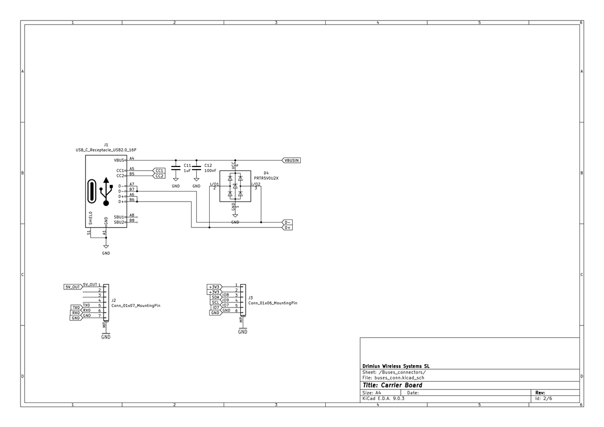

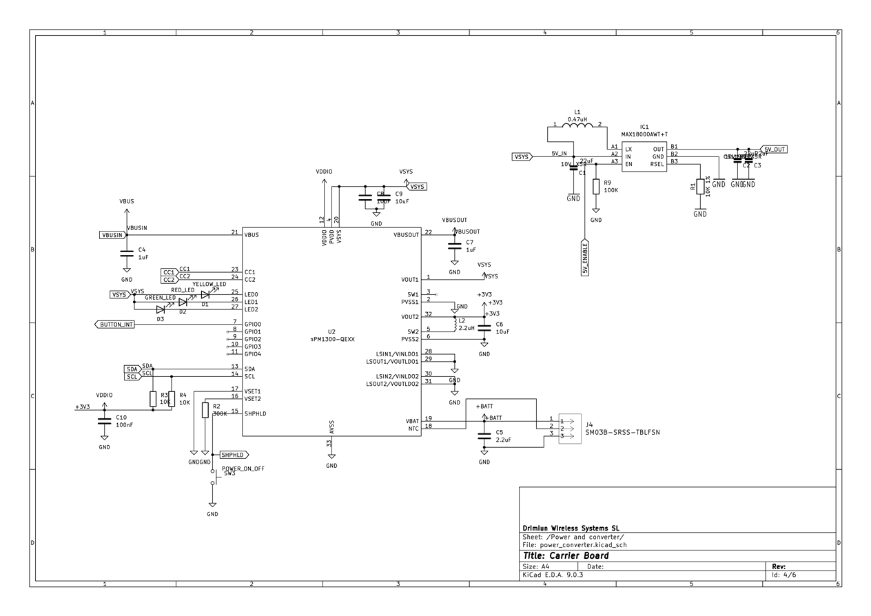

I'm working with a custom PCB, with nPM1300 and a microcontroller.
The problem is that working only with battery the nPM1300 VBUS pin show 2.4V and I cannot put the nPM1300 in Ship Mode.
Any hint?

The schematics.
Q1: When you have battery connected to the nPM1300 output you only see 2.4V on the VBUS pin, but when there's no battery you measure the full 5V?
Yes, when USB its connected I measured 5V. When it´s not connected I measure 2.41V and the content of register VBUSINSTATUS is 0x09 (VBUS present and Undervoltage)
Q2: What are you doing to the nPM to put it into ship mode? How are you configuring it and are other configurations of the nPM possible with the same setup?
I sent shipmode command through i2c. Must be something in design, because I try a new prototype board with no programming and no nPM1300 configuration and VBUS with no USB present measure 2.41V.
Jose Juan said:I try a new prototype board with no programming and no nPM1300 configuration and VBUS with no USB present measure 2.41V.
Where exactly are you measuring, just to be sure.

In the end the bus voltage came from the double rail-to-rail ESD protection diode PRTR5V0U2X, which input de voltage from pin D+ of microcontroller.
Sorry for the inconvenience.
