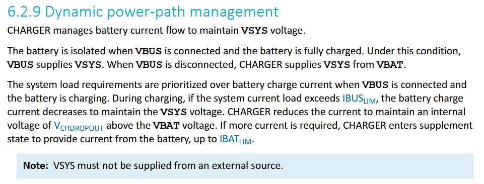

I measure a constant current flow from the battery of 103uA while the nPM is connected to USB and the battery is fully charged.
According to the datasheet 6.2.10:
The battery is isolated when VBUS is connected and the battery is fully charged
Is this a know problem?
    The section 6.2.9 says that battery is isolated, but there's more.
    " If more current is required, CHARGER enters supplement state to provide current from the battery, up to IBATLIM."

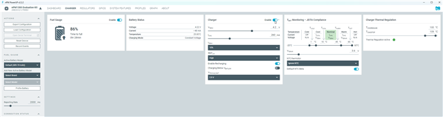

  • It's reproducible with the pmic dk
    here the battery is charging (charger enabled in PC software)
    and then, charging disabled. we have a constant current of about 100uA out of the battery.

    This leakage current from the battery is intentional for safety reasons. It ensures that the battery is not charged to a higher termination voltage than configured by allowing a safe discharge current. ( compensates for the VBUS/USB leakage through the pass FET into the battery, thereby preventing overcharging). For the nPM1300, this safe leakage current of around 100µA is expected behavior.
    There is also an option to automatically restart charging when VBAT drops below VRECHARGE, as described in the nPM1300 product specification
    If this safe leakage current is a concern due to the capacity of your battery (e.g., for very small cells where the drain matters), I would recommend considering the nPM1304 PMIC, which is designed for small-capacity batteries and offers a much lower safe leakage current, close to 5 µA.
