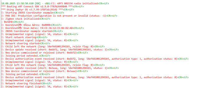

I am using nrf52833-dk for making a ZigBee coordinator. I am using "network coordinator" sample code.
The project is making a ZigBee connection between "nrf52833"(coordinator) and "Aqara Smoke Detector"(End point).
When the smoke detector triggered , i will activate any pin.
I made connection and i got this logs;

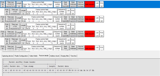

And this logs from sniffer module:
The Aqara module always sends "Data Request". But when i triggered the "Aqara Smoke detector ", i dont see any data from the sensor on the sniffer log screen.
