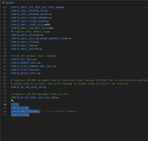

i have enabled below in config file.
# I2C
CONFIG_I2C=y
CONFIG_NRFX_TWIM1=y
CONFIG_GPIO=y

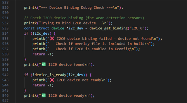

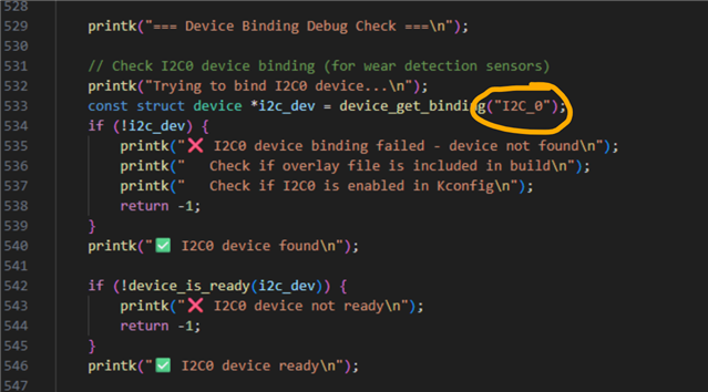

after this i was checking binding in main file but is showing that binding failed.
below is main file screenshort to check binding. so, it is always fail satisfy if and condition and showing binding fail.

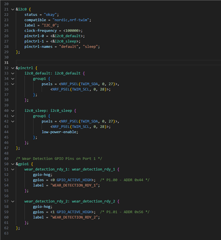

Below is overlay file configuration.
below is config file configuration
i have done changes in existing code of nrf5340 audio code sample. i have not changed anything except this.

  • When selecting an instance for i2c, make sure that instance has not been used before. For example, do not select i2c3 if uart3 is already in use in your project. Try selecting i2c2 for the nRF5340 Audio DK.
    Try something like this in the overlay:
    &i2c2 {
        status = "okay";
        pinctrl-0 = <&i2c2_default>;
        pinctrl-names = "default";
        clock-frequency = <I2C_BITRATE_STANDARD>;
        iqs323: iqs323@44 {
            compatible = "i2c-device";
            reg = <0x44>;
            label = "IQS323";
        iqs7211a: iqs7211a@56 {
            reg = <0x56>;
            label = "IQS7211A";
    &pinctrl {
        i2c2_default: i2c2_default {
            group1 {
                psels = <NRF_PSEL(TWIM_SCL, 0, 26)>,
                        <NRF_PSEL(TWIM_SDA, 0, 25)>;
    Add pinctrl for sleep as well, as seen in this exercise.

  • Would you be able to share the output logs from when the binding error occurs (use Insert->Code in DevZone)? Could you please also share the overlay? Is nrf5340_audio the application you are using? Which nRF Connect SDK is it?
    Have you enabled the config for TWIM number two?
    CONFIG_NRFX_TWIM2=y
