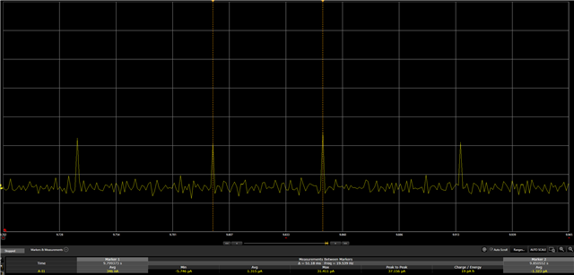

I am trying to do the current measurement for the 2NR EVK in sleep mode.
I am using the "Bluetooth: Peripheral power profiling" application that I was able to build from the Nordic visual studio code.
Here is the example I an using:
https://docs.nordicsemi.com/bundle/ncs-latest/page/nrf/samples/bluetooth/peripheral_power_profiling/README.html
I just flashed this example with all the default settings to the Nordic nRF54L15DK board and Murata 2NR EVK. I am able to get same reading on both of the boards.
I am seeing 1.2 uA whereas the datasheet mentions 0.6 uA. Am I doing something wrong?
I am seeing some peaks in the signal capture. I am using keysight power analyzer to do the current measurement.
