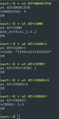

    I generally run AT+CEREG=5 to turn on notifications related to network connections. If I am mobile this will update me when I am moving between cells or if I drop from coverage. This automatically updates on changes to the tower connection.
    AT%CESQ=1 will auto update on RSRP (Signal quality)
    I suggest running Cellular Monitor so that you can capture a trace of the connection. This will provide much more diagnostic information for us to evaluate what is happening.
    Were you successful connecting with the nRF9151DK board with a SIM? If so, use the same SIM on the Thingy91X and try again.
    It can take over 15 minutes for the SIM to update to a new local profile the first time it is uses. Once configured it should attach rapidly.
    We are wanting to see +CEREG indicate 5,1 (home network) or 5,5 (roaming network).

    I’m testing the Thingy:91 X alongside an nRF9151 DK. On the DK, I can attach to LTE without issues using multiple SIMs, but when I move the same SIMs over to the Thingy:91 X, the device hangs indefinitely with the yellow LED flashing (searching for LTE).
    What I’ve tried so far:
    • 4 different SIM cards (2× Conexa, 2× Onomondo)
      • All work fine in the nRF9151 DK
      • None attach when inserted in the Thingy:91 X
    • Followed the Quick Start flow in nRF Connect for Desktop (Start Prototyping)
    • Power cycling, reprogramming via Quick Start, and trying different APN settings
    • AT commands over UART are accepted
    • Tested with and without band locks (no change)
    Cellular Monitor behavior:
    • On the DK, I captured a modem trace and did see an error (attached) perhaps this might help.
    • On the Thingy:91 X, Cellular Monitor seems to get stuck on the initial “TRACE” step and does not progress.
    Question:
    Since the SIMs and network attach correctly on the DK, what could prevent the Thingy:91 X from attaching? Are there extra steps (firmware alignment, bridge firmware, antenna configuration, etc.) that I may have missed in setup?
