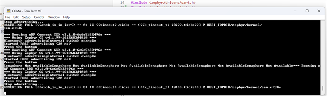

Unfortunately, when the program call the bt_le_adv_stop() the program crashes with the following error:
Press the button
Stop advertising...
ASSERTION FAIL [((arch_is_in_isr() == 0) || ((timeout).ticks == (((k_timeout_t) {0})).ticks))] @ WEST_TOPDIR/zephyr/kernel/sem.c:136
I am curious to know if there is an easy way to get around this crash.
