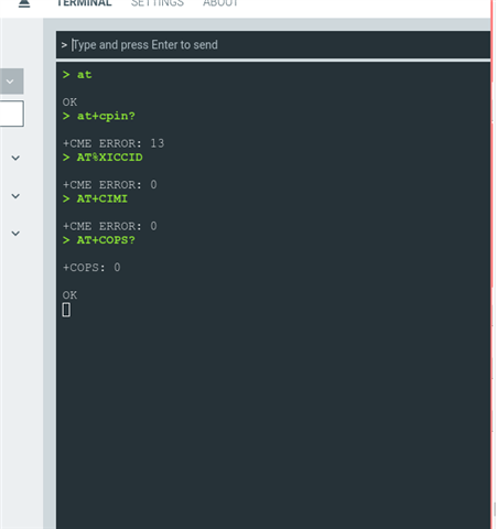

    We are testing after desoldering the eSIM and following the same steps, but neither the eSIM nor the physical SIM is working. We are not able to measure 1.8V on the SIM interface.
    For your reference, we have attached a video showing the issue.
    We also tested the following AT commands, but none of them worked:
    AT+CPIN? → failed: +CME ERROR AT+CIMI → failed: +CME ERROR: 13 AT%XICCID → failed: +CME ERROR: 0 AT+CPINR="..." → failed: +CME ERROR: 0
    Additionally, we tried:
    AT+CFUN=0 AT+CFUN=1
    but we did not observe any voltage spike on the SIM interface.
    Kindly check the attached video and advise us on how to resolve this issue.

  • We are using the nRF9151 DK board for testing. Kindly check the attached video and AT command log screenshot for your reference.
    During testing, we observed that neither the eSIM nor the physical SIM is working, and no 1.8V is present on the SIM interface. We also tried several AT commands, but they all failed with errors.
    Could you please review the attached materials and advise us on how to resolve this issue?
