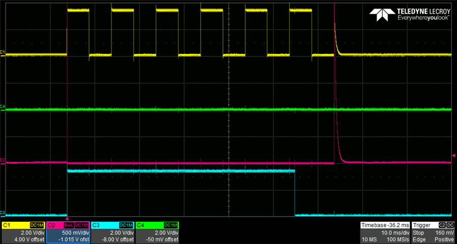

we're using multiple pwm-channels of one module of the nRF54L15 for different purposes (multiple motors, h-bridge control; depending on the project).
When the first channel is being turned on or the last channel is being turned off we're seeing spikes on all configured channels - which seems to be unexpected behaviour to us.
We are currently able to work around this (in the h-bridge case just by the correct disable-sequence, in the other case by using different pwm-modules), but still it would be great to have a clean solution here.
Btw - the off spike looks like it changes the drive-mode of the pin, since it's not a clean edge to GND but looks like a discharge curve.
Here is a screenshot of this (I can measure the exact spike width, if needed):
C1 is the inactive pwm-channel, c2 the active one. C3 and C4 are the statically driven gpio's of the h-bridge.

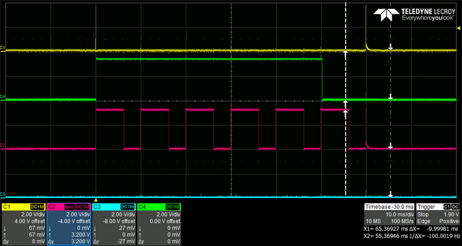

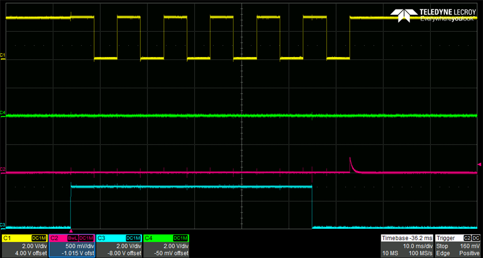

    another Update from my side - I have a minimal test-project to test this attached to this post.
    I also tested this on an nRF52840 and I can still see a small spike, although it does only get up to about 0.3V.
    Here a screenshot of the nRF52840 result from the testproject:
    And from the nRF54L15:
    Note that Channel 2 is set to 500mV/div to better see the spike especially on the nRF52840.
    I also just realized, that the dts-overlay on the nRF52840 probably doesn't deactivate polarity-inversion - so this might be the reason for different default pin-level on Channel 1.

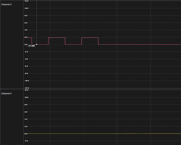

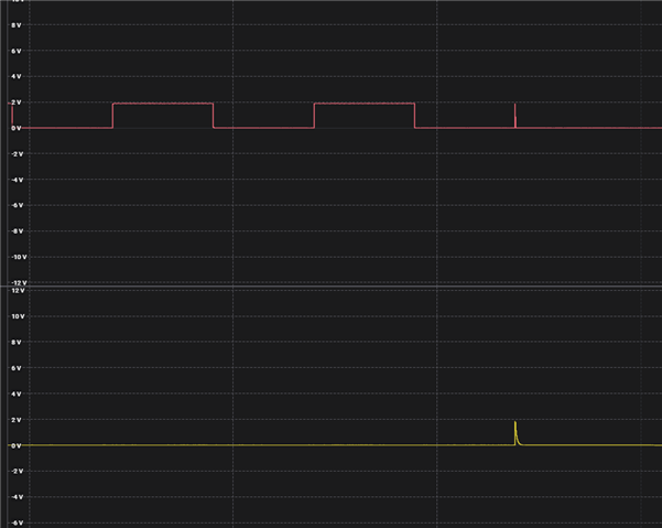

    Could you try with NCS v3.1.0, and see if the issue is solved there?
    I'm seeing some strange spikes with NCS 3.0.2, but not with NCS 3.1.0
    NCS 3.0.2
    NCS 3.1.0
    BR,
    Sigurd
  • Hi Sigurd,
    thank you very much for the feedback - I just tested it myself and it looks great now!
    Do you have any idea what change fixed this? Just out of curiosity!
    Best regards
    Marco
    Great!
    I believe it was fixed with this commit here: https://github.com/nrfconnect/sdk-zephyr/commit/c1d7194e05c3798e2acc6a461247eb20e5d27a0a
