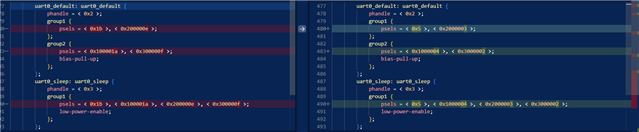

  • Are you using an overlay file that you did not upload in the zip? I get this when I diff your zephyr.dts file with mine
  • No overlay, double checked. I don't see the register addresses in my 9151 board pinctrl file, that must get translated during build into the dts file.
    Should I reinstall SDK 3.0.2?nrf9151dk_nrf9151_common-pinctrl.dtsinrf9151dk_nrf9151_common.dtsi

  • My nrf9151dk_nrf9151_common-pinctrl.dtsi does not match yours, it is likely that the file on my system was inadvertently changed. I have pasted your content in and will test UART log functionality today.
  • Big thanks Hakon, the correct nrf9151dk_nrf9151_common-pinctrl.dtsi did the trick. I must have accidently changed the file while creating the board definitions for our custom board.
