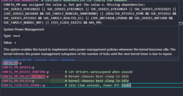

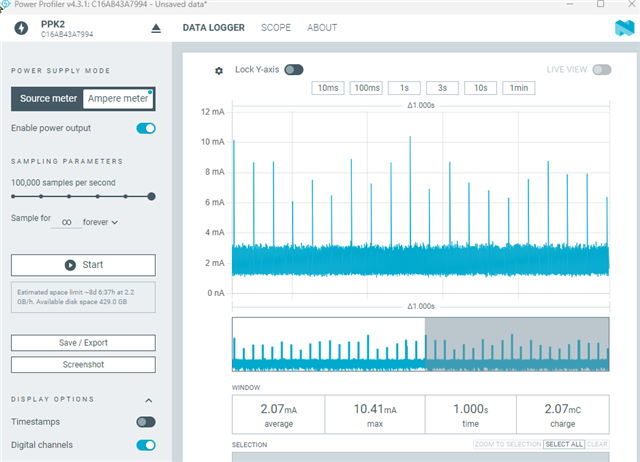

Still I get 7-8mA consumption when everything is idle (idle task?)
Tried the following
CONFIG_PM=y
CONFIG_PM_DEVICE=y
CONFIG_PM_DEVICE_RUNTIME=y         # Let drivers autosuspend when unused
CONFIG_PM_POLICY_DEFAULT=y         # Kernel chooses best sleep in idle
CONFIG_TICKLESS_KERNEL=y           # Idle time extends, fewer RTC ticks
but it keeps drawing 7mA...
What is the easiest way to cut the power down?
For a start,  I don't need an aggressive power optimization, just to take this constant current draw down ...
