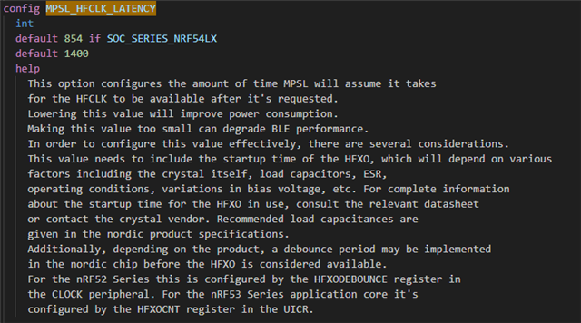

Try to change CONFIG_MPSL_HFCLK_LATENCY=1500

From what I read, increasing MPSL_HFCLK_LATENCY impacts power consumption.
Could you clarify the relationship between MPSL_HFCLK_LATENCY and the HFXO internal capacitor configuration as described above? Which approach would be the most appropriate to resolve the issue?.
HauJohn said:MPSL_HFCLK_LATENCY
Use this one yes.

As I understand, the most accurate method is to use a spectrum analyzer through a radio test to precisely determine the required capacitor value for stable radio clock operation. Increasing MPSL_HFCLK_LATENCY is only a workaround, correct?
Could you explain in detail what aspects are affected by increasing MPSL_HFCLK_LATENCY? For example, does it impact data transmission speed, power consumption during data transfer, etc.
This is directly related to the settling time of the HFXO, in nRF Connect SDK v2.9.x it simply was configured to short.

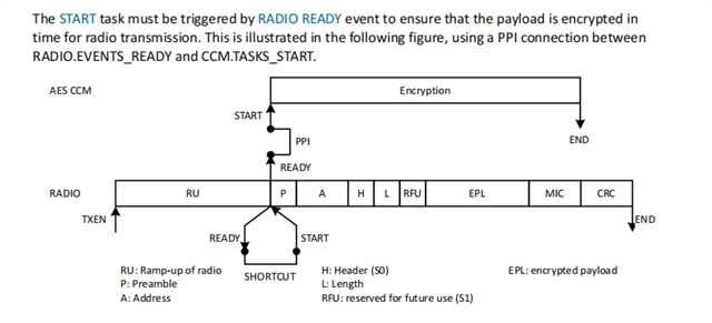

I just want to clearly understand what the parameter CONFIG_MPSL_HFCLK_LATENCY means. Is it the ramp-up time during packet transmission and reception as shown in this diagram?
If that’s the case, then increasing this parameter could reduce the transmission speed, right?
No, it's telling the software how far ahead of the BLE event that it should startup the HFCLK.
