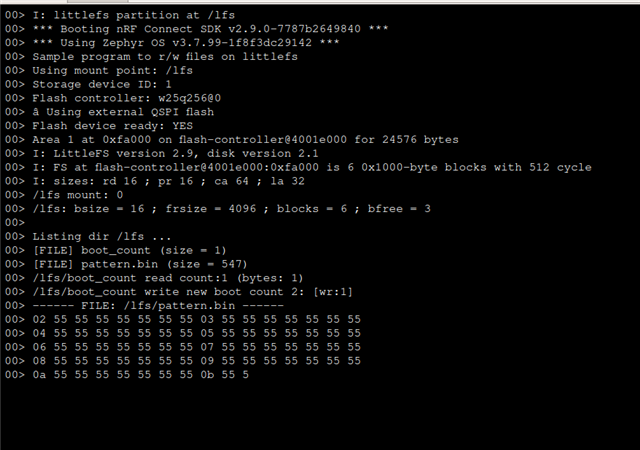

littlefs not mount to external flash winbond w25q256
am trying to mount little fs example with my external flash  winbond w25q256  but my nrf52840 board taking internal memory and am using  qspi
it get automount and writing in  internal memory (mx25r64) and this is my overlay
i have tried with little fs example

    Thank you for attaching this. For future references, please use the insert -> code functionality to make it easier to review the contents of your reply (such as I've edited your reply to show):
    Is this the sample you've based your application on?
    There should be a sample that you can use directly for the nrf52840dk with the qspi external flash overlay set up https://github.com/zephyrproject-rtos/zephyr/blob/main/samples/subsys/fs/fs_sample/boards/nrf52840dk_nrf52840_qspi.overlay which should work out of the box if you add a pm_static.yml as well as modify the overlay to use your winbound external flash instead of the mx25
    Andreas

    00> *** Booting nRF Connect SDK v2.9.0-7787b2649840 ***
    00> *** Using Zephyr OS v3.7.99-1f8f3dc29142 ***
    00> === 406 Byte Continuous Write Demo ===
    00> Writing 406 bytes to external flash every 1000 ms
    00> Max file size: 10 MB, Max total usage: 25 MB
    00> Using mount point: /lfs
    00> Storage device ID: 1
    00> Flash controller: flash-controller@4001e000
    00> Flash device ready: YES
    00> QSPI device: w25q256ve@0
    00> QSPI device ready: YES
    00> Using internal flash
    00> === FLASH AREA INFO ===
    00> Area ID: 1
    00> Offset: 0x0
    00> Size: 8388608 bytes (8192 KB)
    00> Device: w25q256ve@0
    00> ✓ Using EXTERNAL QSPI flash
    00> =====================
    00> flash area flatten ...
    00> storage device ID to: 1
    00> I: LittleFS version 2.9, disk version 2.1
    00> I: FS at w25q256ve@0:0x0 is 128 0x10000-byte blocks with 512 cycle
    00> I: sizes: rd 16 ; pr 16 ; ca 64 ; la 32
    00> E: WEST_TOPDIR/modules/fs/littlefs/lfs.c:4531: Invalid block count (64 != 128)
    00> W: can't mount (LFS -22); formatting
    00> I: /lfs mounted
    00> manual mounted
    00> /lfs mount: 0
    00> Cleaning up old files...
    00> === FILESYSTEM STATS ===
    00> Total: 8192 KB, Used: 128 KB, Free: 8064 KB
    00> Data writ
    00> --- Write cycle #5 ---
    00> E: erase error: address or size exceeds expected values.Addr: 0x480000 size 65536
    00> E: file write error (-22)
    00> E: FAIL: write /lfs/data406_001.bin: -22
    00> E: Failed to write 406 bytes: -22
    00>
