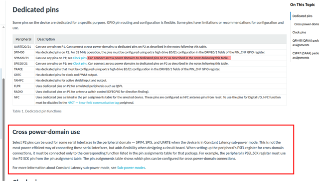

We are working with nRF54L15 connected to an external flash memory MX25R64.
Our setup uses MCUboot with a secondary partition located on the external flash.

  • When running normally (without debugging session started), data is not written to the external flash (secondary MCUboot partition).
  • When a debugging session started, the same update procedure works correctly, and all chunks are written to flash as expected.

    This seems very strange, and I haven’t been able to find any similar reports of it. Are you able to test the same code on a nRF54L15 DK to see if you get the same result?
  • Yes, the problem reproduces on the devkit. I prepared an example based on our configuration.
    So you can try it yourself.
    repository
  • Thanks. Yes, I was able to reproduce. The problem occurs when the chip enters low power mode between transactions. Your sample also worked when I added NRF_POWER->TASKS_CONSTLAT=1; to the beginning of main().
