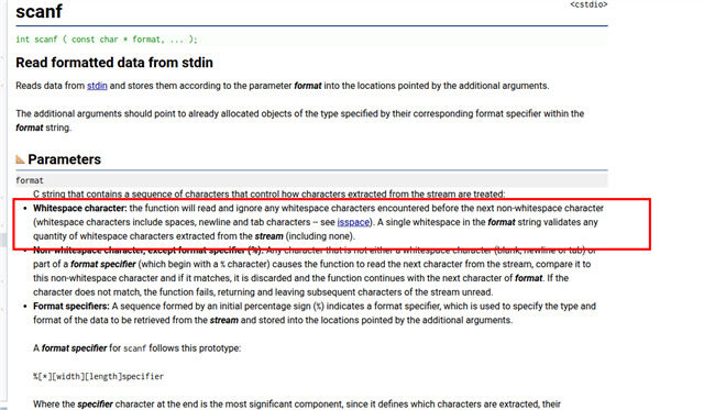

    It seems like you have scanf ignore a leading newline by inserting a whitespace before the format specifier. So scanf(" %s", string1); instead of scanf("%s", string1);
    https://cplusplus.com/reference/cstdio/scanf/

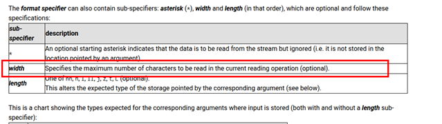

    I would consider setting a max width for scanf to not allow the string buffer to potentially overflow.
