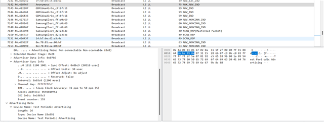

Hi all,
Im testing the "periodic_advertising_example" but in wireshark (nrf52840 dongle) I can just receive the AUX_ADV_IND packet below. I can I see the periodic advertising data ?
Thanks.

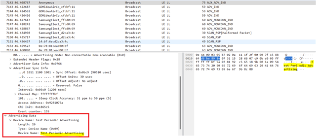

The advertising data is as you see in the sniffer log.
Amanda H.

What I cant see in the sniffer are the "peridic advertising data" ; I mean reading the example code in the while (true) there is the following call:
Check this post.

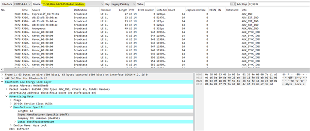

Please enable the Interface Toolbar for nRF Sniffer via View -> Interface Toolbar -> nRF Sniffer for Bluetooth LE
Follow up on your device from the Interface Toolbar.
