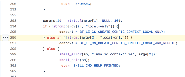

    If you look into cmd_create_config() (in zephyr/subsys/bluetooth/host/shell/cs.c) you'll find a bug in the test for argv[2] (it's checking "local-only" twice, rather than "local-remote" in the second case), which makes me uncertain how much this code has actually been used.
    If you can get a working sequence going, it would be much appreciated.
