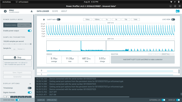

I'm working on optimizing the power consumption on my nRF52840 DK and need some guidance. Currently measuring ~5µA average idle current via PPK2, but I need to reduce this further for my application.
IMAGE:

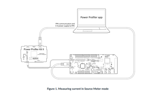

    It looks like you may be seeing some USB noise from the interface. Please try to use the PPK2 in source mode instead as this should lead to less noise in the measurements (see Measuring current in Source Meter mode).

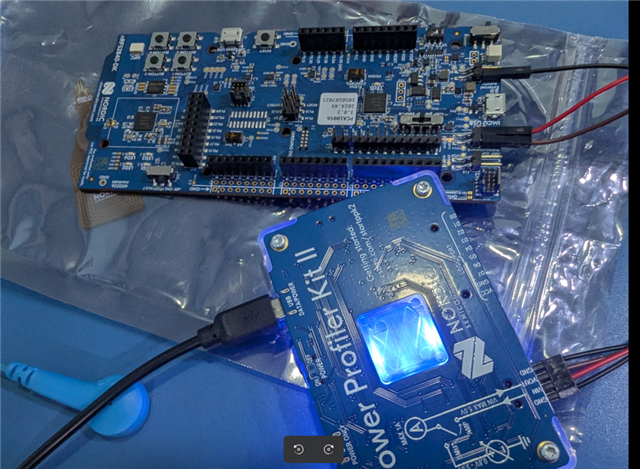

    After your recommendation, I tried different modes and obtained the following results:
    Ammeter with Coin Cell
    Configuration:
    Result:
    same result as when connected with usb
    Source Meter

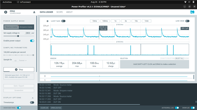

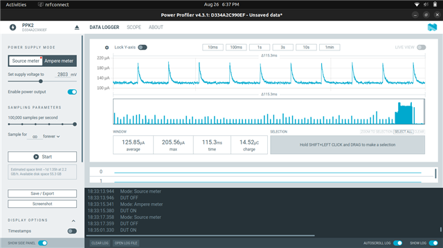

    Configuration:
    Result with vext->nRF switch off
    saw increase in idle current to greater than 100ua!!

  • The USB cable must still be connected to the DK to supply the supporting curcuitry like the interface MCU to avoid leakage. VDD is also closer to 3 volt.
