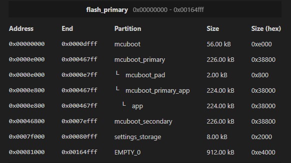

  • With config nrf54l15dk/nrf54l15/cpuapp build with success
    Memory region         Used Size  Region Size  %age Used
               FLASH:       41224 B        54 KB     74.55%
                 RAM:       22200 B       188 KB     11.53%
            IDT_LIST:          0 GB        32 KB      0.00%
    so, what to do with configuration nrf54l15dk/nrf54l05/cpuap ? What settings should be applied to fit in a memory (error: section `datas' will not fit in reg ion `FLASH').

  • Wrong alignment now work's
    but still would like to know about earlier questions.

    reichel said:
    1) On L15 "have" magic from dtsi set to 0x165000 for maximum size of app if config was generated automatically. I see this number in zephyr\dts\vendor\nordic\nrf54l15.dtsi but for cpuflpr and my app is for configuration cpuapp (and PM manager do not allow me to build smaller region) For L05 I see in dts 0x75800 but If I create app without bootloader in partition.yml I've got 0x7d000 (so full 512). Could you explain ?
    We set it do 500k by default as flpr is not supported on the l05 and l10 variant yet. https://github.com/nrfconnect/sdk-zephyr/blob/dc15a79bfeb842bfb503fd63017e8cb371050ddf/dts/vendor/nordic/nrf54l05_partition.dtsi#L7
    https://github.com/nrfconnect/sdk-zephyr/blob/dc15a79bfeb842bfb503fd63017e8cb371050ddf/dts/vendor/nordic/nrf54l10_partition.dtsi#L7
    reichel said:
    2) Now (without soft device) there is no common BT stack ? Because simple app is huge and have more than 220kb, so with dual bank, there is no possibility to use mcuboot (any option for single, like in older way ?) Without very hard optimization (maybe should go back to nrf52 ...). Is there any way to use a single bank ?
    There’s no single‑bank BLE DFU in NCS. For BLE DFU, you need dual‑bank (two slots). Only the serial recovery mode supports the single bank. See https://academy.nordicsemi.com/courses/nrf-connect-sdk-intermediate/lessons/lesson-9-bootloaders-and-dfu-fota/topic/exercise-1-dfu-over-uart/
    For the nRF54L05 BLE DFU, I suggest building the pm_static_nrf54l15dk_nrf54l05_cpuapp_release.yml to avoid slot allocation issues.
  • so if set for flpr why is used for cpuapp during generation of partition.yml ?
    Link to pm_static_nrf54l15dk_nrf54l05_cpuapp_release.yml gives 404, not sure should I log to , add repo , ?!
    BTW. it is not a problem of calculating partition etc. This is normal day. But I feel that documentation and zephyr are a little bit underdeveloped. It supposedly "solves" a lot of issues, but if something doesn't work, you have to dig deeper (today I came across a library for the HDC2080 again, it supposedly exists, but only a little, and the rest needs to be added anyway... so maybe it would be easier to write it from scratch without all that overhead...)
  • No, it doesn't set as flpr is not supported for nRF54L05.
    That's an internal link. Here is the content:

  • thank you.
    Yes, now when I shrink code via config and could run build with default partitions, I observed for L05 that fill region in a good way, not sure why they created two empty blocks but maybe this is solution (SIC!) for the gaps

    not sure why (I based on this info, because earlier I tested this on L15) they stick to 0x165000 which is not full 1.5M (3*7d000)

    this is also auto-generated from a simple L15 configuration (thus I guess that for l05 could be same but now I see that they use full available memory so set as the biggest end address 7d000)
    The EMPTY blocks are for alignment.  Since the gap size between mcuboot and flash_primary for alignment is 0x800, I set CONFIG_PM_PARTITION_SIZE_MCUBOOT=0xd000 in sysbuild/mcuboot.conf for L05 to reduce the mcuboot, which results in a partition without empty blocks.
