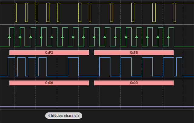

nRF54H20 SPI CS assert issue
Hi
I'm trying to communicate with ICM45686 using nRF54H20 and SPI CLK, MISO, MOSI state appear correct but CS pin is not asserting/deasserting
following it the scope capture, Yellow CS, Green Clock, Blue MOSI, Purple is MISO.
Note: this is only one capture and CS behaviour is completely noisy (undeterministic)
Following are Pin ctrl and spi133 node definition from zephyr.dts
&pinctrl {
    /omit-if-no-ref/ spi133_default: spi133_default {
		group1 {
			psels = <NRF_PSEL(SPIM_SCK, 2, 2)>,
				<NRF_PSEL(SPIM_MOSI, 2, 5)>,
				<NRF_PSEL(SPIM_MISO, 2, 6)>;
	/omit-if-no-ref/ spi133_sleep: spi133_sleep {
		group1 {
			low-power-enable;
&spi133 {
	status = "okay";
	pinctrl-0 = <&spi133_default>;
	pinctrl-1 = <&spi133_sleep>;
	memory-regions = <&cpuapp_dma_region>;
	cs-gpios = <&gpio2 7 (GPIO_ACTIVE_LOW)>;
And i'm using SPI_SHELL commands as follows
spi conf spi133 200000
spi transceive spi133 0xF2 0x55
