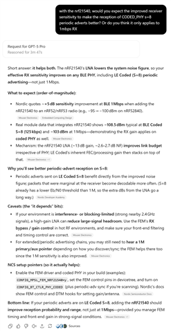

  2. Does the NRF21540 also improve RX sensitivity of CODED_PHY periodic adverts (S=8, 125kbps)? Has this been evaluated? Is there any data on this?

I would still like to know if the 21540 improves the RX for CODED_PHY if there's any info available on that.

    Q2: Regarding RX sensitivity on CODED_PHY. It looks like the GPT-5 summary is good and would be along the lines of what we would say as well. Perhaps we would focus more on the "it depends" bit, because often there is noise in the 2.4GHz band and you will see something between the theoretical best and the no gain scenario. Most likely you'll see a bit of gain on RX with coded phy, but there's also a higher risk for collisions as it takes you longer to send packages/data with the 125kbps mode.
