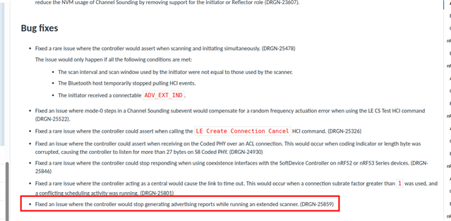

I have a project to use Multi Role of BLE.
peripheral advertise 300ms period.
central scan 2m 30s period. ( actual scan is about 10s, Scan Param Interval 50ms, window 25ms //  scan 10s, sleep 140s scan 10s ...)
scan start ,stop function is executed user Thread(priority 7)
sometime after 1~3 days(I don't know exactly Time), scan Callback is not called.
it means that the function bt_le_scan_start, bt_le_scan_stop is success, but callback is not called. after starting callback is not called, callback is not called forever.
First I thought some collision advertising and scanning, however it is weird that not calling callback is continuous.
1. the reason is advertising and scanning collision?
2. is any solution?
