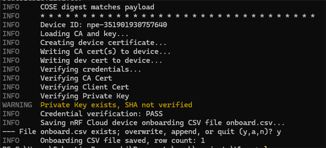

Hi Øyvind - thanks for pointing out the documentation.
I was successful in creating the certificates and uploading them to my device:
The provisioned device shows up in nRF Cloud
And it appears that the certificates were successfully uploaded to the modem (over the AT client interface)

Nevermind - just needed to add the '-' to the name:
Working beautifully now - thanks.
