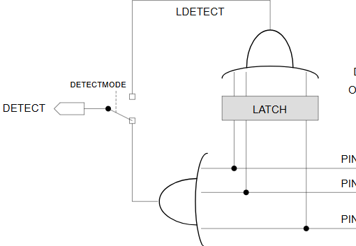

The nRF52840 supports two wakeup detect modes: Default detect (non-latch) and Latch detect (LDETECT). In our use case the interrupt source is not an edge but a signal that can stay active (high or low).

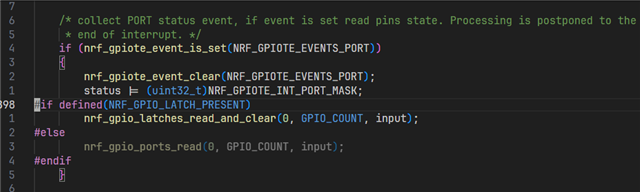

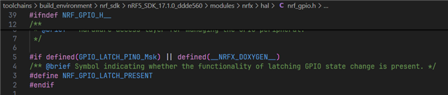

SDK v17 introduces new latch handling in the GPIO library. For nRF52840, this is always enabled through NRF_GPIO_LATCH_PRESENT macro.
We never explicitly enable latch mode (via NRF_GPIO->DETECTMODE = GPIO_DETECTMODE_DETECTMODE_LDETECT << GPIO_DETECTMODE_DETECTMODE_Pos;), however the ISR still uses latch detect clearing mechanisms even when this is not enabled.
Because our interrupt signals can stay active, the latch never resets → the MCU ends up stuck in the loop inside port_event_handle(uint32_t * latch) (called from interrupt context). This effectively makes every GPIO interrupt susceptible to the same issue if the input signal stays asserted.
We tested by commenting out #define NRF_GPIO_LATCH_PRESENT, and then everything works fine without latch handling — but this is not expected behaviour. We don’t want to modify the SDK just to achieve this. Is there a supported way to disable latch detect without patching the SDK?

    The driver doesn't enable the LDETECT mode, so the latch register bits are not going trigger the PORT event either. The driver will always uses the LATCH register as long as it's supported by the HW (indicated by the presence of the NRF_GPIO_LATCH_PRESENT symbol). This was not designed to be configurable as there are no known drawbacks of using it. It should only make the interrupt handling more robust.

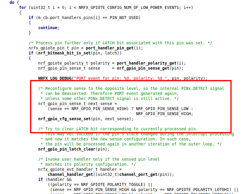

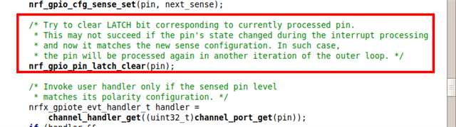

    Note that the sense level is reconfigured in the ISR to prevent exactly this:

    From what I observe, it ends up calling port_event_handle, and then contuine; on the below check, so the level reconfiguration is not happening, continues again on the while loop non stop.

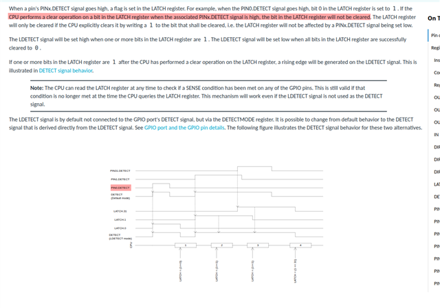

    I’m not sure I fully understand — if LDETECT is not enabled, how does using the LATCH register make the interrupt handling more robust?
    As per the nRF documentation I see: “A PORT event is triggered if the DETECT signal was low before enabling the sense mechanism”. If I understand correctly, the current port event handler doesn’t account for this case.
    because the latch bit will still be set even if the DETECT signal has been deasserted.
    This case appears to have been considered based on the comment here:

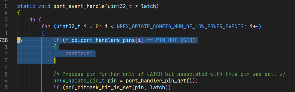

    .hi_accuracy is set to true for all our interrupts, but still port_event_handle() is getting called. Based on my testing, port_event_handle() is getting called especially in cases like “A PORT event is triggered if the DETECT signal was low before enabling the sense mechanism”, even if .hi_accuracy is set to true, and it is stuck in while loop.
    Is it always latched for the same pin?
    Yes, but with .hi_accuracy is set to true, it continues with next iteration from if(m_cb.port_handlers_pins[i] == PIN_NOT_USED).
    Will latch bit staying set matter if the detect mode is "non-latch" ?
    But for me the code execution never reaches here, as I mentioned before.
    Yes.
    Then the given pin has not been initialized with hi_accuracy=false.
    GPIOTE inputs initialzied with .hi_accuracy=true should not be configured with SENSE enabled.
