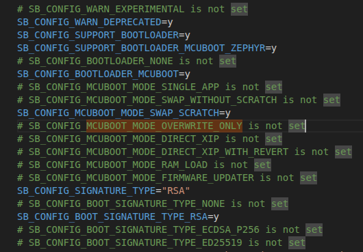

hi Nordic.. i am trying to follow this link https://devzone.nordicsemi.com/nordic/nordic-blog/b/blog/posts/exploring-the-benefits-of-mcuboots-compressed-image-support .. in order to check how much compression i can get on my image (i am working with ncs v2.8.0 for an nrf52840 device and i m already using DFU via BLE).. i added the relevant configs to the sysbuild.conf but no indication for compression .. i even changed the secondary image partition size just in case by 4kb .. then i see this warning
warning: MCUBOOT_COMPRESSED_IMAGE_SUPPORT (defined at /xxx/ncs/v2.8.0/nrf/sysbuild/Kconfig.mcuboot:47) was assigned the value 'y' but got the value 'n'. Check these unsatisfied dependencies: MCUBOOT_MODE_OVERWRITE_ONLY (=n). See http://docs.zephyrproject.org/latest/kconfig.html#CONFIG_MCUBOOT_COMPRESSED_IMAGE_SUPPORT and/or look up MCUBOOT_COMPRESSED_IMAGE_SUPPORT in the menuconfig/guiconfig interface. The Application Development Primer, Setting Configuration Values, and Kconfig - Tips and Best Practices sections of the manual might be helpful too. and i am not sure yet what overwrite my "SB_CONFIG_MCUBOOT_MODE_OVERWRITE_ONLY=y" that i have in my app/sysbuild.conf
.. any ideas what am i missing ?

    Error indicates that you have not enabled SB_CONFIG_MCUBOOTLOADER_OVERWRITE_ONLY. Please confirm that this symbol is selected in your build.

  • it is present in the sysbiuld.conf
    SB_CONFIG_BOOTLOADER_MCUBOOT=y
    SB_CONFIG_BOOT_SIGNATURE_TYPE_RSA=y
    SB_CONFIG_PARTITION_MANAGER=y
    SB_CONFIG_PM_OVERRIDE_EXTERNAL_DRIVER_CHECK=y
    SB_CONFIG_MCUBOOT_COMPRESSED_IMAGE_SUPPORT=y
    but i do not see it in the .config file in the build (both app and mcuboot) so it is clear that it is not included i just don't know why it is overwritten or ignored

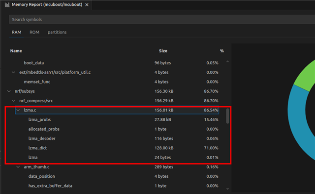

  • There's a third .config file for sysbuild located in build/zehpyr that contains the sysbuild configuration. Anyway, I tried building the provided "mcuboot_update" sample with nrf52dk/52832 as the target and it didn't give this Kconfig warning, but failed at linking as there was way to little RAM. Turns out the compression algorithm required a lot more RAM (at least with the default configs) than I expected:
  • not sure where the third .config is .. did not find it yet .
    but anyway not sure how it helps me cause my app does not fail on size it just does not compress and the warning i shared seems to me like the reason why
    any idea why this config gets overwritten ?
    plus i am pretty sure that the compression can be configured to be less effective and fast and b that consume less ram

  • Did you look for the  .config file in your build/zephyr folder?
    Hard to say based on the information provided. You can try to build the sample application (mcuboot_update) to see if you get the same result.
