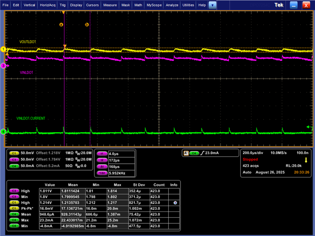

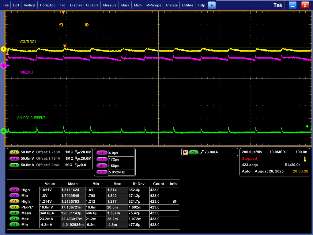

4. At LDO mode, we set VOUTLDO1 1.2V, we can see frequency peak about 6KHz as below pic.
    a, The ~6KHz peak is because SW1 VOUT1 in PFM mode?
    b. The VOUTLDO1 also have ~6KHz peak, since it's LDO mode, I think the VOUTLDO1 should be stable and not affected by VINLDO1, or it is a normal situation for nPM1300 LDO?

    4. LDO operates in sampled mode when buck is in PFM mode and no charging enabled. This sampling can cause some ripple on the output voltage. You could check if this ripple you see goes away if you start charging for example. Then LDOs are in continuous mode and you should not see the LDO reference refresh caused ripple anymore.
    This ripple can be also caused by the buck converter operating in PFM mode depending how you are powering LDOs etc. and what is the load of the buck. Care should be taken also how to ground the oscilloscope probe to avoid GND bounce affecting the measurement. You can experiment forcing buck to PWM mode to see how it effects the ripple.
