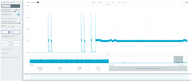

    Measuring the power usage with a PPK2, I'm getting about 55 uA with the device powered from the PPK2, which drops to 0.38 uA as expected after putting it into ship mode. I tried pressing the button a few times to wake it, and each time I pressed the button, it spiked up to ~1 mA a couple of times and then back down to nA range. On the third press, it got stuck drawing a constant 1 mA.
    I've attached two recordings. The first recorded the device being powered for a while, then put into ship mode, then me pressing the reset button a few times and seeing the current draw get stuck at 1 mA. The second recording continues from that state and shows me holding the reset button for 10 seconds to do a hard reset. (The current spikes just before entering ship mode and just after resetting are because I have an LED set to blink 3 times before entering ship mode and twice when it boots.)
     ppk2-20251111T024233 on, ship mode, wake attempt.ppk2ppk2-20251111T024336 ship mode, hard reset.ppk2
