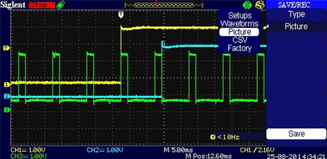

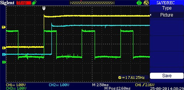

The notifications are synchronized with the radio Active signal (a flag is set in the radio notification event handler, and then notification is sent in the main loop). I expect the data to be sent the nearest connection interval but with the GAP event length of 2.5ms they are actually sent in the next connection interval:
Yellow – peripheral sends notification
Blue – data is received at central
Green – radio events at peripheral
2.5 ms seems to be enough time to send 29 bytes of data, so why they are sent the next connection interval?
BTW, when I increase the GAP event length to 3.75ms, the data is sent the nearest connection interval
What can cause such a behavior? Is it some kind of internal buffering in the softdevice?

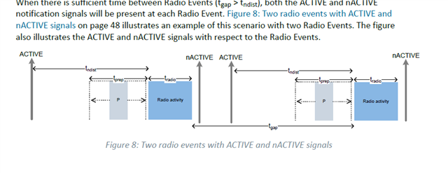

    I think there can be a race condition here. If you trigger a radio notification at the exact time when the stack planning to wake up and handle the connection interval, there could be not enough time for the CPU to queue the data to the stack and then the stack schedule the packet into the connection event.
    The scheduling to send a packet in a connection would need to happen before the actual radio activity occurs.
    Have you used the T_ndist to set a distance before the connection event occurs to queue the data ?
    (Chapter 11 in S140 softdevice specification)
