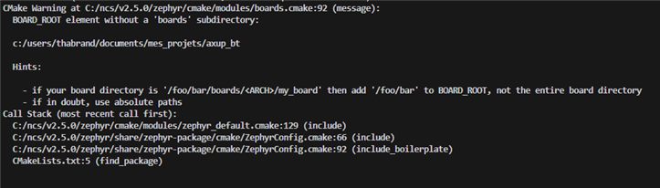

I've juste came back from holidays and I no longer can do pristine build on my applications (no matter which toolchain or SDK I am using).

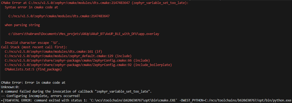

When I do pristine build I have this error :
I've found that when I do edit build configuration all my devicetree overlays and kconfig fragments are missing. I have to select them again and do a standard build. After that I can do only standard build. If I go again in edit build configuration there are mssing and if I do pristine build I have the error above again.
I think the issue come from the version 2025.8.654 of the nRF Connect for VS Code extension.
