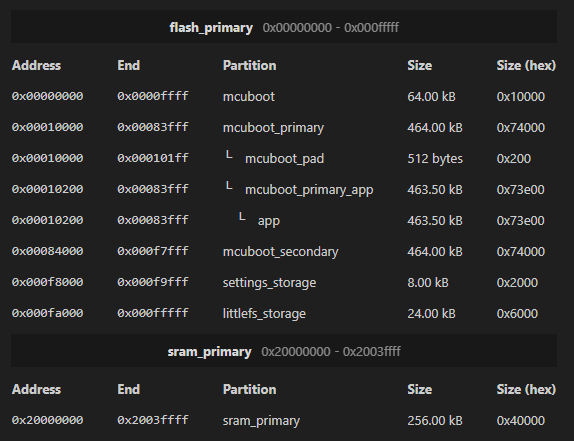

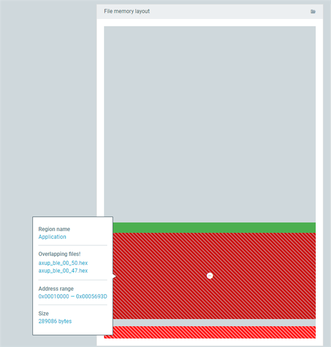

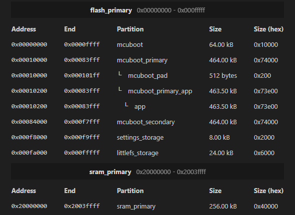

  • Hello
    I am facing the same issue. I feel like it is related to the application size even if the settings partition is exactly the same in both partitions manager.
    I explain myself : I programmed 2 different versions (47 and 50) of my BLE peripheral application in 2 application slots of 1 product. Both versions have differences, not related to advertising or pairing, but they ended up not having the same size. I connect my product in v50 to my phone with bounding etc, everything is fine I can reset either my phone or my product and they re connect automaticaly.  When I swap my product in v47 with nRF Connect application for smartphone I can't connect to my phone anymore, I have disconencted reason 19 in the log of my product meaning bouding informations have been lost. But if i swap back my product to v50 I can connect again.
    Here is screenshots illustrating my words :
    Screenshot from the programmer of nRF Connect for Desktop, showing both application are of different sizes.
    v47 partitions manager
    v50 partitions manager
    My applications are based on sdk v2.5.0.
    May the issue come from the settings_load() function ? Maybe instead of looking to a particular address it is using the difference between the end of the application and the beginning of settings storage partition ?
