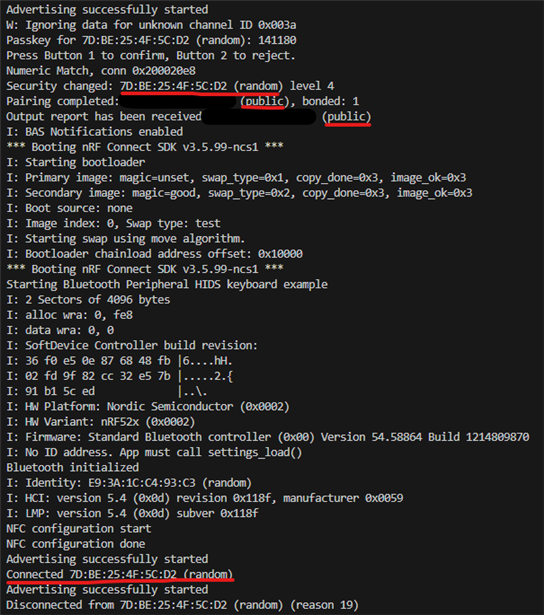

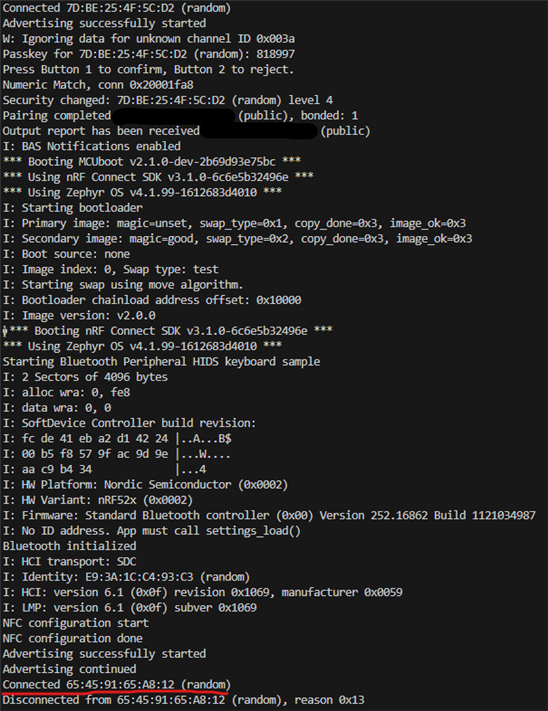

I am using nrf connect sdk v2.6.0. I have noticed that after DFU update, I am seeing ble bonding lost randomly on firmware side. I did uncheck Erase Application Settings before DFU and I tried on both Device Manager app as well as nrf connect app and on both Android/IOS. I am attaching dts snippet and prj.conf for reference.
Thanks M
