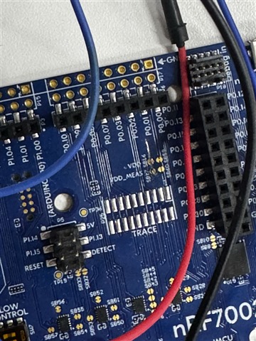

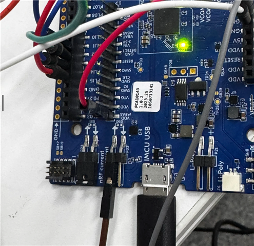

Instead, I used another approach:
  • I supplied an external 3.3 V power source.
  • Connected the power line to header P22.
  • Bridged SB12 by soldering.
  • Cut SB16 to disconnect it.
Now, VDD_MEAS is powered, and the camera is supplied through the VDD_MEAS pin.

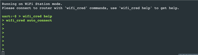

  • However, when I switch to STA mode and try to input Wi-Fi connection commands in the Serial Terminal (nRF Connect for Desktop), my command line no longer works — I cannot type any input.

I suspect the issue is related to powering the board through P22 jumper.

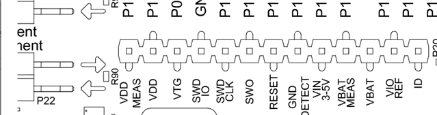

    I believe your line of thought is correct. The reason why it will not work in this setup, is because the debugger IC, running the USB/UART bridge, is running on 1.8V. This creates a mismatch when your device runs on 3.3V
    If your apply 3.3V to the pin "VIO REF" on pin header P22, this should also power the debugger IC at 3.3V:
    Could you try this?
