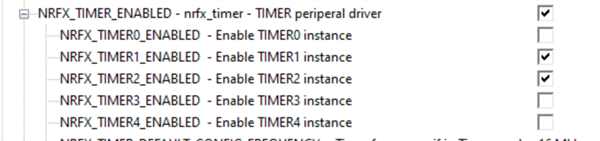

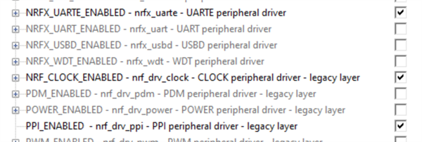

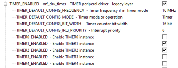

I want to use the async driver,but did not find the example or explanation.
I have looked for the whole examples with "nrf_libuarte_async.h", found nothing,a little strange,I guess the NRF_LOG should useed this lib,but not check yet.
  • found one:nRF5_SDK_17.1.0_ddde560\examples\peripheral\libuarte.
    defined :
    NRF_LIBUARTE_ASYNC_DEFINE(m_libuarte, 0, 0,0,NRF_LIBUARTE_PERIPHERAL_NOT_USED, NRF_SDH_BLE_GATT_MAX_MTU_SIZE, 2)
    error:
    Build target 'UART2BLEnrf52810_xxaa'
    compiling app_uarte.c...
    ..\..\..\app_uarte.c(7): error:  #94: the size of an array must be greater than zero
    ..\..\..\app_uarte.c(7): error:  #20: identifier "NRFX_TIMER0_INST_IDX" is undefined
    ..\..\..\app_uarte.c: 0 warnings, 3 errors
    ".\_build\UART2BLEnrf52810_xxaa.axf" - 3 Error(s), 0 Warning(s).

  • Solved.
    In order to use the Macro NRF_LIBUARTE_ASYNC_DEFINE,you have to confirm:
    1) include all files needed:
    nrfx_ppi.c
    nrfx_timer.c
    nrf_libuarte_drv.c
    nrf_libuarte_async.c
    (there is problem if you try to use RTC timer)
    2)enable these drivers in sdk_config.h;
    This is the main source of error.
    As my case:
    NRF_LIBUARTE_ASYNC_DEFINE(m_libuarte, 0, 1,    NRF_LIBUARTE_PERIPHERAL_NOT_USED, 2,  NRF_SDH_BLE_GATT_MAX_MTU_SIZE * 2, 3);
    I use UARTE0,TIMER1,TIMER2.
    You should not just enbale NRFX drivers, you have to enable legacy TIMER1 & TIMER2 driver.
    Problems come mainly from here.
    The Macro does not think the TIMERx is enabled if you did not enable legacy drivers,and the tip info provided by NRF_LIBUARTE_ASYNC_DEFINE is meaningless.
    These kind of info should include into the official explaination,I spend many hours to try error.
