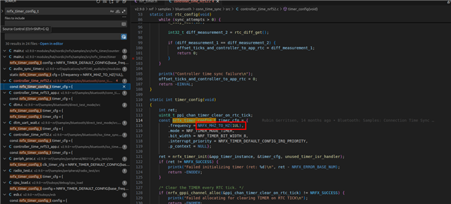

    The timer init function is returning "NRFX_ERROR_INVALID_PARAM" (195887108 / 0x0BAD0004), most likely due to the .frequency value. The NRF_TIMER_FREQ_* enum specifies the prescaler value, while the driver expects the frequency in hertz. Please replace the line  " .frequency = NRF_TIMER_FREQ_2MHz," with ".frequency = NRFX_MHZ_TO_HZ(2UL),"
