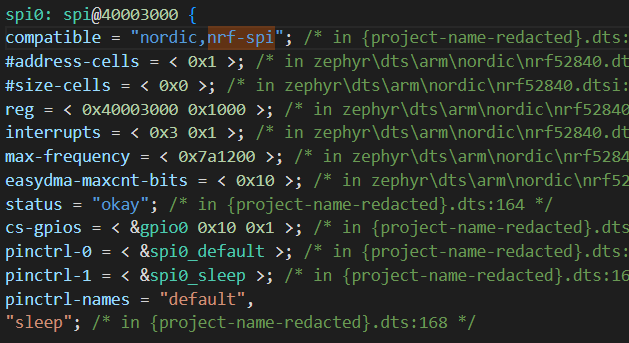

Power draw increases after setting CONFIG_PM_DEVICE_RUNTIME=y
I was using an SPI serial nor flash device with NCS 2.8.0. I tried to get the flash into deep power down mode, but it doesn't seem to work well with NCS 2.8.0. So I upgraded to 3.1.0
In itself this gives the same current consumption within the margin of error.
I now set CONFIG_PM_DEVICE_RUNTIME=y and in my flash device initialisation I call pm_device_runtime_enable() on the flash device and the DPD commands appear on the SPI bus as expected.
However, with CONFIG_PM_DEVICE_RUNTIME and DPD enabled, the overall current draw is now slightly higher than before, and if I don't call pm_device_runtime_enable for the flash device then it is higher again. I was expecting this to reduce overall consumption, not increase it.
2.8.0, no CONFIG_PM_DEVICE_RUNTIME = 51uA
3.1.0, no CONFIG_PM_DEVICE_RUNTIME = 52uA
3.1.0, CONFIG_PM_DEVICE_RUNTIME=y, no DPD = 63uA
3.1.0, CONFIG_PM_DEVICE_RUNTIME=y, DPD enabled = 55uA
How has enabling CONFIG_PM_DEVICE_RUNTIME made it worse?
Simon
    Could you tell me which nRF device you are working with? Are you using a custom board or a development kit? If you are working with a custom board, were you able to observe the same behavior on a development kit?
    Abhijith
  • Hi Menon,
    This is an nRF52840 on a custom board. It's embedded in an Ezurio BL654 module. I have not tried on a development kit for a long time as our code is heavily dependent on having the peripheral ICs. I can tell you there are a couple of I2C devices, an analog voltage read (using the ADC) and a PDM module.
    As a further update, I disabled CONFIG_PM_DEVICE_RUNTIME again. The flash DPD mode no longer worked automatically, but it did work if I sent the  pm_device_action_run() calls manually.
    Simon
    I am not entirely sure about the issue you’re seeing. Could you enable debug-level logs? They might help identify the cause of the device waking up. I understand that enabling logs can affect your measurements, but it would be helpful to see the root cause of the issue. You can disable them afterwards.
    Also, could you please share the zephyr.dts file from the build folder?
    Abhijith
    Debug level logs are already on and don't show anything. I don't think there is anything waking up, it seems more like something not going into lowest power state.
    Here's the zephyr.dts content:

    /* node '/soc/spi@40003000' defined in zephyr\dts\arm\nordic\nrf52840.dtsi:152 */
    spi0: spi@40003000 {
    compatible = "nordic,nrf-spi"; /* in {project-name-redacted}.dts:163 */
    #address-cells = < 0x1 >; /* in zephyr\dts\arm\nordic\nrf52840.dtsi:161 */
    #size-cells = < 0x0 >; /* in zephyr\dts\arm\nordic\nrf52840.dtsi:162 */
    reg = < 0x40003000 0x1000 >; /* in zephyr\dts\arm\nordic\nrf52840.dtsi:163 */
    interrupts = < 0x3 0x1 >; /* in zephyr\dts\arm\nordic\nrf52840.dtsi:164 */
    max-frequency = < 0x7a1200 >; /* in zephyr\dts\arm\nordic\nrf52840.dtsi:165 */
    easydma-maxcnt-bits = < 0x10 >; /* in zephyr\dts\arm\nordic\nrf52840.dtsi:166 */
    status = "okay"; /* in {project-name-redacted}.dts:164 */
    cs-gpios = < &gpio0 0x10 0x1 >; /* in {project-name-redacted}.dts:165 */
    pinctrl-0 = < &spi0_default >; /* in {project-name-redacted}.dts:166 */
    pinctrl-1 = < &spi0_sleep >; /* in {project-name-redacted}.dts:167 */
    pinctrl-names = "default",
    "sleep"; /* in {project-name-redacted}.dts:168 */
    /* node '/soc/spi@40003000/spi-nor@0' defined in {project-name-redacted}.dts:169 */
    spi_flash: spi-nor@0 {
    compatible = "jedec,spi-nor"; /* in {project-name-redacted}.dts:170 */
    reg = < 0x0 >; /* in {project-name-redacted}.dts:171 */
    spi-max-frequency = < 0x7a1200 >; /* in {project-name-redacted}.dts:172 */
    requires-ulbpr; /* in {project-name-redacted}.dts:173 */
    has-dpd; /* in {project-name-redacted}.dts:174 */
    t-exit-dpd = < 0xbb8 >; /* in {project-name-redacted}.dts:175 */

    /* node '/soc/spi@4002f000' defined in zephyr\dts\arm\nordic\nrf52840.dtsi:535 */
    spi3: spi@4002f000 {
    compatible = "nordic,nrf-spim"; /* in zephyr\dts\arm\nordic\nrf52840.dtsi:536 */
    #address-cells = < 0x1 >; /* in zephyr\dts\arm\nordic\nrf52840.dtsi:537 */
    #size-cells = < 0x0 >; /* in zephyr\dts\arm\nordic\nrf52840.dtsi:538 */
    reg = < 0x4002f000 0x1000 >; /* in zephyr\dts\arm\nordic\nrf52840.dtsi:539 */
    interrupts = < 0x2f 0x1 >; /* in zephyr\dts\arm\nordic\nrf52840.dtsi:540 */
    max-frequency = < 0x1e84800 >; /* in zephyr\dts\arm\nordic\nrf52840.dtsi:541 */
    easydma-maxcnt-bits = < 0x10 >; /* in zephyr\dts\arm\nordic\nrf52840.dtsi:542 */
    rx-delay-supported; /* in zephyr\dts\arm\nordic\nrf52840.dtsi:543 */
    rx-delay = < 0x2 >; /* in zephyr\dts\arm\nordic\nrf52840.dtsi:544 */
    status = "disabled"; /* in zephyr\dts\arm\nordic\nrf52840.dtsi:545 */
    /* node '/soc/gpio@50000000' defined in zephyr\dts\arm\nordic\nrf52840.dtsi:548 */
    gpio0: gpio@50000000 {
    compatible = "nordic,nrf-gpio"; /* in zephyr\dts\arm\nordic\nrf52840.dtsi:549 */
    gpio-controller; /* in zephyr\dts\arm\nordic\nrf52840.dtsi:550 */
    reg = < 0x50000000 0x200 0x50000500 0x300 >; /* in zephyr\dts\arm\nordic\nrf52840.dtsi:551 */
    #gpio-cells = < 0x2 >; /* in zephyr\dts\arm\nordic\nrf52840.dtsi:553 */
    status = "okay"; /* in {project-name-redacted}.dts:127 */
    port = < 0x0 >; /* in zephyr\dts\arm\nordic\nrf52840.dtsi:555 */
    gpiote-instance = < &gpiote >; /* in zephyr\dts\arm\nordic\nrf52840.dtsi:556 */
    phandle = < 0x4 >; /* in {project-name-redacted}.dts:165 */
    /* node '/soc/gpio@50000300' defined in zephyr\dts\arm\nordic\nrf52840.dtsi:559 */
    gpio1: gpio@50000300 {
    compatible = "nordic,nrf-gpio"; /* in zephyr\dts\arm\nordic\nrf52840.dtsi:560 */
    gpio-controller; /* in zephyr\dts\arm\nordic\nrf52840.dtsi:561 */
    reg = < 0x50000300 0x200 0x50000800 0x300 >; /* in zephyr\dts\arm\nordic\nrf52840.dtsi:562 */
    #gpio-cells = < 0x2 >; /* in zephyr\dts\arm\nordic\nrf52840.dtsi:564 */
    ngpios = < 0x10 >; /* in zephyr\dts\arm\nordic\nrf52840.dtsi:565 */
    status = "okay"; /* in {project-name-redacted}.dts:131 */
    port = < 0x1 >; /* in zephyr\dts\arm\nordic\nrf52840.dtsi:567 */
    gpiote-instance = < &gpiote >; /* in zephyr\dts\arm\nordic\nrf52840.dtsi:568 */
    phandle = < 0xd >; /* in {project-name-redacted}.dts:30 */
    /* node '/soc/crypto@5002a000' defined in zephyr\dts\arm\nordic\nrf52840.dtsi:571 */
    cryptocell: crypto@5002a000 {
    compatible = "arm,cryptocell-310"; /* in zephyr\dts\arm\nordic\nrf52840.dtsi:572 */
    reg = < 0x5002a000 0x1000 >,
    < 0x5002b000 0x1000 >; /* in zephyr\dts\arm\nordic\nrf52840.dtsi:573 */
    reg-names = "wrapper",
    "core"; /* in zephyr\dts\arm\nordic\nrf52840.dtsi:574 */
    interrupts = < 0x2a 0x1 >; /* in zephyr\dts\arm\nordic\nrf52840.dtsi:575 */
    status = "okay"; /* in zephyr\dts\arm\nordic\nrf52840.dtsi:576 */
    /* node '/pin-controller' defined in zephyr\dts\vendor\nordic\nrf_common.dtsi:25 */
    pinctrl: pin-controller {
    compatible = "nordic,nrf-pinctrl"; /* in zephyr\dts\vendor\nordic\nrf_common.dtsi:30 */
    /* node '/pin-controller/uart0_default' defined in {project-name-redacted}-pinctrl.dtsi:7 */
    uart0_default: uart0_default {
    phandle = < 0x2 >; /* in {project-name-redacted}.dts:150 */
    /* node '/pin-controller/uart0_default/group1' defined in {project-name-redacted}-pinctrl.dtsi:8 */
    group1 {
    psels = < 0xf >; /* in {project-name-redacted}-pinctrl.dtsi:9 */
    /* node '/pin-controller/uart0_default/group2' defined in {project-name-redacted}-pinctrl.dtsi:11 */
    group2 {
    psels = < 0x1000011 >; /* in {project-name-redacted}-pinctrl.dtsi:12 */
    bias-pull-up; /* in {project-name-redacted}-pinctrl.dtsi:13 */
    /* node '/pin-controller/uart0_sleep' defined in {project-name-redacted}-pinctrl.dtsi:17 */
    uart0_sleep: uart0_sleep {
    phandle = < 0x3 >; /* in {project-name-redacted}.dts:151 */
    /* node '/pin-controller/uart0_sleep/group1' defined in {project-name-redacted}-pinctrl.dtsi:18 */
    group1 {
    psels = < 0xf >; /* in {project-name-redacted}-pinctrl.dtsi:19 */
    low-power-enable; /* in {project-name-redacted}-pinctrl.dtsi:20 */
    /* node '/pin-controller/uart0_sleep/group2' defined in {project-name-redacted}-pinctrl.dtsi:22 */
    group2 {
    psels = < 0x1000011 >; /* in {project-name-redacted}-pinctrl.dtsi:23 */
    bias-pull-up; /* in {project-name-redacted}-pinctrl.dtsi:24 */
    /* node '/pin-controller/spi0_default' defined in {project-name-redacted}-pinctrl.dtsi:28 */
    spi0_default: spi0_default {
    phandle = < 0x5 >; /* in {project-name-redacted}.dts:166 */
    /* node '/pin-controller/spi0_default/group1' defined in {project-name-redacted}-pinctrl.dtsi:29 */
    group1 {
    psels = < 0x4000005 >,
    < 0x5000007 >; /* in {project-name-redacted}-pinctrl.dtsi:30 */
    /* node '/pin-controller/spi0_default/group2' defined in {project-name-redacted}-pinctrl.dtsi:33 */
    group2 {
    psels = < 0x6000006 >; /* in {project-name-redacted}-pinctrl.dtsi:34 */
    bias-pull-up; /* in {project-name-redacted}-pinctrl.dtsi:35 */
    /* node '/pin-controller/spi0_sleep' defined in {project-name-redacted}-pinctrl.dtsi:39 */
    spi0_sleep: spi0_sleep {
    phandle = < 0x6 >; /* in {project-name-redacted}.dts:167 */
    /* node '/pin-controller/spi0_sleep/group1' defined in {project-name-redacted}-pinctrl.dtsi:40 */
    group1 {
    < 0x5000007 >; /* in {project-name-redacted}-pinctrl.dtsi:41 */
    bias-pull-up; /* in {project-name-redacted}-pinctrl.dtsi:43 */
    /* node '/pin-controller/spi0_sleep/group2' defined in {project-name-redacted}-pinctrl.dtsi:45 */
    group2 {
    psels = < 0x6000006 >; /* in {project-name-redacted}-pinctrl.dtsi:46 */
    low-power-enable; /* in {project-name-redacted}-pinctrl.dtsi:47 */
    /* node '/pin-controller/i2c1_default' defined in {project-name-redacted}-pinctrl.dtsi:51 */
    i2c1_default: i2c1_default {
    phandle = < 0x7 >; /* in {project-name-redacted}.dts:182 */
    /* node '/pin-controller/i2c1_default/group1' defined in {project-name-redacted}-pinctrl.dtsi:52 */
    group1 {
    psels = < 0xc000018 >,
    < 0xb000019 >; /* in {project-name-redacted}-pinctrl.dtsi:53 */
    /* node '/pin-controller/i2c1_sleep' defined in {project-name-redacted}-pinctrl.dtsi:58 */
    i2c1_sleep: i2c1_sleep {
    phandle = < 0x8 >; /* in {project-name-redacted}.dts:183 */
    /* node '/pin-controller/i2c1_sleep/group1' defined in {project-name-redacted}-pinctrl.dtsi:59 */
    group1 {
    < 0xb000019 >; /* in {project-name-redacted}-pinctrl.dtsi:60 */
    low-power-enable; /* in {project-name-redacted}-pinctrl.dtsi:62 */
    /* node '/pin-controller/pdm0_default' defined in {project-name-redacted}-pinctrl.dtsi:66 */
    pdm0_default: pdm0_default {
    phandle = < 0x9 >; /* in {project-name-redacted}.dts:141 */
    /* node '/pin-controller/pdm0_default/group1' defined in {project-name-redacted}-pinctrl.dtsi:67 */
    group1 {
    psels = < 0x14000017 >,
    < 0x15000020 >; /* in {project-name-redacted}-pinctrl.dtsi:68 */
    /* node '/pin-controller/pdm0_sleep' defined in {project-name-redacted}-pinctrl.dtsi:72 */
    pdm0_sleep: pdm0_sleep {
    phandle = < 0xa >; /* in {project-name-redacted}.dts:142 */
    /* node '/pin-controller/pdm0_sleep/group1' defined in {project-name-redacted}-pinctrl.dtsi:73 */
    group1 {
    psels = < 0x14000017 >; /* in {project-name-redacted}-pinctrl.dtsi:74 */
    bias-pull-down; /* in {project-name-redacted}-pinctrl.dtsi:75 */
    /* node '/pin-controller/pdm0_sleep/group2' defined in {project-name-redacted}-pinctrl.dtsi:77 */
    group2 {
    psels = < 0x15000020 >; /* in {project-name-redacted}-pinctrl.dtsi:78 */
    low-power-enable; /* in {project-name-redacted}-pinctrl.dtsi:79 */
    /* node '/entropy_bt_hci' defined in zephyr\dts\vendor\nordic\nrf_common.dtsi:33 */
    rng_hci: entropy_bt_hci {
    compatible = "zephyr,bt-hci-entropy"; /* in zephyr\dts\vendor\nordic\nrf_common.dtsi:34 */
    status = "okay"; /* in zephyr\dts\vendor\nordic\nrf_common.dtsi:35 */
    /* node '/sw-pwm' defined in zephyr\dts\vendor\nordic\nrf_common.dtsi:38 */
    sw_pwm: sw-pwm {
    compatible = "nordic,nrf-sw-pwm"; /* in zephyr\dts\vendor\nordic\nrf_common.dtsi:39 */
    status = "disabled"; /* in zephyr\dts\vendor\nordic\nrf_common.dtsi:40 */
    generator = < &timer1 >; /* in zephyr\dts\vendor\nordic\nrf_common.dtsi:41 */
    clock-prescaler = < 0x0 >; /* in zephyr\dts\vendor\nordic\nrf_common.dtsi:42 */
    #pwm-cells = < 0x3 >; /* in zephyr\dts\vendor\nordic\nrf_common.dtsi:43 */
    /* node '/cpus' defined in zephyr\dts\arm\nordic\nrf52840.dtsi:15 */
    cpus {
    #address-cells = < 0x1 >; /* in zephyr\dts\arm\nordic\nrf52840.dtsi:16 */
    #size-cells = < 0x0 >; /* in zephyr\dts\arm\nordic\nrf52840.dtsi:17 */
    /* node '/cpus/cpu@0' defined in zephyr\dts\arm\nordic\nrf52840.dtsi:19 */
    cpu@0 {
    device_type = "cpu"; /* in zephyr\dts\arm\nordic\nrf52840.dtsi:20 */
    compatible = "arm,cortex-m4f"; /* in zephyr\dts\arm\nordic\nrf52840.dtsi:21 */
    reg = < 0x0 >; /* in zephyr\dts\arm\nordic\nrf52840.dtsi:22 */
    #address-cells = < 0x1 >; /* in zephyr\dts\arm\nordic\nrf52840.dtsi:23 */
    #size-cells = < 0x1 >; /* in zephyr\dts\arm\nordic\nrf52840.dtsi:24 */
    /* node '/cpus/cpu@0/itm@e0000000' defined in zephyr\dts\arm\nordic\nrf52840.dtsi:26 */
    itm: itm@e0000000 {
    compatible = "arm,armv7m-itm"; /* in zephyr\dts\arm\nordic\nrf52840.dtsi:27 */
    reg = < 0xe0000000 0x1000 >; /* in zephyr\dts\arm\nordic\nrf52840.dtsi:28 */
    swo-ref-frequency = < 0x1e84800 >; /* in zephyr\dts\arm\nordic\nrf52840.dtsi:29 */
    /* node '/clocks' defined in zephyr\dts\arm\nordic\nrf52840.dtsi:34 */
    clocks {
    /* node '/clocks/hfxo' defined in zephyr\dts\arm\nordic\nrf52840.dtsi:35 */
    hfxo: hfxo {
    compatible = "nordic,nrf52-hfxo"; /* in zephyr\dts\arm\nordic\nrf52840.dtsi:36 */
    clock-frequency = < 0x3d09000 >; /* in zephyr\dts\arm\nordic\nrf52840.dtsi:37 */
    startup-time-us = < 0x578 >; /* in zephyr\dts\arm\nordic\nrf52840.dtsi:38 */
    #clock-cells = < 0x0 >; /* in zephyr\dts\arm\nordic\nrf52840.dtsi:39 */
    /* node '/leds' defined in {project-name-redacted}.dts:27 */
    leds {
    compatible = "gpio-leds"; /* in {project-name-redacted}.dts:28 */
    /* node '/leds/led_0' defined in {project-name-redacted}.dts:29 */
    led0: led_0 {
    gpios = < &gpio1 0x9 0x0 >; /* in {project-name-redacted}.dts:30 */
    label = "LED"; /* in {project-name-redacted}.dts:31 */
    /* node '/wake_pin' defined in {project-name-redacted}.dts:35 */
    wake_pin {
    compatible = "gpio-keys"; /* in {project-name-redacted}.dts:36 */
    /* node '/wake_pin/accel_int_1' defined in {project-name-redacted}.dts:37 */
    accel_int: accel_int_1 {
    gpios = < &gpio1 0x2 0x0 >; /* in {project-name-redacted}.dts:38 */
    label = "Accel INT1"; /* in {project-name-redacted}.dts:39 */
    /* node '/uart_rx_pin' defined in {project-name-redacted}.dts:43 */
    uart_rx_pin {
    compatible = "gpio-keys"; /* in {project-name-redacted}.dts:44 */
    /* node '/uart_rx_pin/uart_rx_int' defined in {project-name-redacted}.dts:45 */
    uart_rx_int: uart_rx_int {
    gpios = < &gpio0 0x11 0x1 >; /* in {project-name-redacted}.dts:46 */
    label = "UART pin interrupt"; /* in {project-name-redacted}.dts:47 */
    /* node '/mic_pwr_pin' defined in {project-name-redacted}.dts:51 */
    mic_pwr_pin {
    compatible = "gpio-leds"; /* in {project-name-redacted}.dts:52 */
    /* node '/mic_pwr_pin/mic_pwr' defined in {project-name-redacted}.dts:53 */
    mic_pwr: mic_pwr {
    gpios = < &gpio0 0x13 0x0 >; /* in {project-name-redacted}.dts:54 */
    label = "MEMS power"; /* in {project-name-redacted}.dts:55 */
    /* node '/bat_mon' defined in {project-name-redacted}.dts:59 */
    bat_mon {
    compatible = "gpio-leds"; /* in {project-name-redacted}.dts:60 */
    /* node '/bat_mon/bat_mon_ena' defined in {project-name-redacted}.dts:61 */
    bat_mon_ena: bat_mon_ena {
    gpios = < &gpio1 0x8 0x0 >; /* in {project-name-redacted}.dts:62 */
    label = "Battery Monitor Enable"; /* in {project-name-redacted}.dts:63 */
    /* node '/charge_status' defined in {project-name-redacted}.dts:67 */
    charge_status {
    compatible = "gpio-keys"; /* in {project-name-redacted}.dts:68 */
    /* node '/charge_status/chg_stat' defined in {project-name-redacted}.dts:69 */
    chg_stat: chg_stat {
    gpios = < &gpio0 0x1b 0x1 >; /* in {project-name-redacted}.dts:70 */
    label = "Charger Active"; /* in {project-name-redacted}.dts:71 */
    /* node '/charge_status/charge_end' defined in {project-name-redacted}.dts:73 */
    charge_end: charge_end {
    gpios = < &gpio0 0x1a 0x0 >; /* in {project-name-redacted}.dts:74 */
    label = "Charge Terminate"; /* in {project-name-redacted}.dts:75 */
    /* node '/bat_switch' defined in {project-name-redacted}.dts:79 */
    bat_switch {
    compatible = "regulator-fixed"; /* in {project-name-redacted}.dts:80 */
    regulator-name = "lipo-battery-switch"; /* in {project-name-redacted}.dts:81 */
    enable-gpios = < &gpio0 0xc 0x0 >; /* in {project-name-redacted}.dts:82 */
    regulator-boot-on; /* in {project-name-redacted}.dts:83 */
    /* node '/zephyr,user' defined in {project-name-redacted}.dts:86 */
    zephyr,user {
    io-channels = < &adc 0x2 >; /* in {project-name-redacted}.dts:87 */
    io-channel-names = "VBAT"; /* in {project-name-redacted}.dts:88 */
    Can you check if this is causing leakage and resulting in higher current? Leave SCK/MOSI/MISO floating during sleep.
