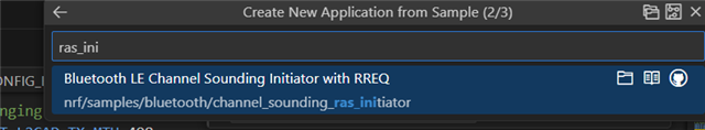

I have run the example in ncs 3.1.0 for CS_RAS_Initiator and compared to the older version ncs 3.0.1, there is a new flag called realtime_rd. Thanks to this, I can get new distance measurement data every 250 ms, which is great.
