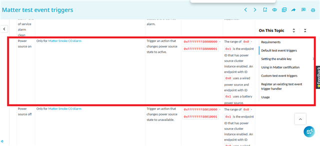

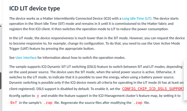

As per the provided documentation for the Matter: Smoke/CO Example,
we have configured the CONFIG_CHIP_ICD_DSLS_SUPPORT Kconfig option to y,
and updated the ICD Management Cluster’s feature map by setting its value to 0xF.
As you mentioned triggering event for power source endpoint switching from endpoint 0 to 1 for the battery power source.
using the given triggering event command.
Event successfully triggered (As we can see in log print)
But unfortunately, ICD Mode does not switch from SIT to LIT.

I: 194191 [EM]>>> [E:6871r S:865 M:227437443] (S) Msg RX from 1:000000000001B66)
I: Event Trigger: Power Source on endpoint id 1 activated.
I: 194211 [EM]<<< [E:6871r S:865 M:49669992 (Ack:227437443)] (S) Msg TX from 00)

Could you please guide me on why the device does not enter LIT mode on a change to battery supply event trigger?
Is the GetICDMode() function called correctly?
