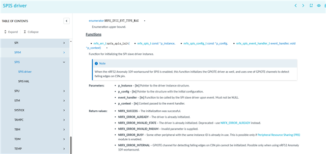

Isn't this NRF code
Thank you for your patient response above
LinJunXuan said:Isn't this NRF code
Yes, this is from the low-level SPIS nrfx driver. Generally the nrfx drivers are low-level and can be used directly, but for most there als exist a Zephyr API on top that is normally what is recommended. You are free to use the nrfx QSPI driver direclty as well if you like (see nrfx_qdec.h), but I would recommend the Zephyr APIs and we do not have any example for using nrfx_qdec directly.
