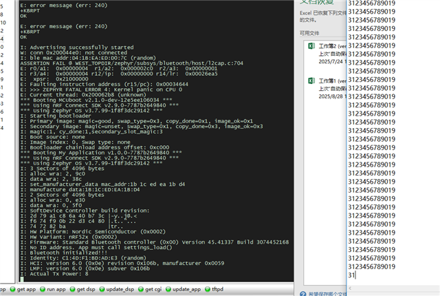

Conn 0x200044e0:not connected
I am programming with ncs v2.9.0 based on nrf52833 chip
And base on peripheral_hid and central_hid
Testing that peripheral send data continuesly to central,and about 3 hours later, peripheral side report conn 0x200044e0 : not connected, then err.
I wonder why this happend, i am sure that central is connected to peripheral all the time.
below is peripheral side's log
