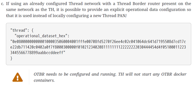

  •   I’ve got the setup working, but only by running OTBR on a separate Raspberry Pi.
    With the Test Harness (TH) configuration where OTBR runs in Docker on the same host, there appear to be networking/visibility issues between containers: the container with chip-tool doesn’t see traffic from the OTBR container. Commissioning starts but times out right after the DUT connects to OTBR.
    I observed the same behavior when running the nRF Matter Lock sample (SDK 3.1.0) with TH v2.13 + Summer 2025 with connected nRF Dongle as RCP.
    Using 9.1.3.b solved issue with communication to DUT.
    I've one more issue. I cannot commission device with custom DAC and PAA. I've placed PAA certificate in /var/paa-root-certs directory and setup chip_use_paa_certs flag to True. All according to chapter 9.1.4 in TH documentation. Commissioning fails just after receiving all attestation data by chip-tool in docker container.
    I've been able to commission that device to standalone chip-tool with connected paa path by --paa-trust-store-path /home/matter/paa.
  • I've found the issue, I've setup paa-trust-store-path to /var/paa-root-certs instead of just /paa-root-certs. It's cause of that it is started in docker volumes
