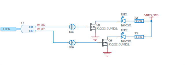

Unable to control GPIOs pin in nrf7002DK

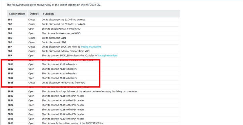

For my project I need to control 3 gpios pins. I already found difficult to find gpios that were not already used internally.
I decided to use the gpio0 - 8,9,10 they were used by spi4 but since I don't need it for my project I disabled it

    aliases {
        redpin = &red_pin;
        greenpin = &green_pin;
        bluepin = &blue_pin;
    rgb_leds {
        compatible = "gpio-leds";
        red_pin: red_pin {
            gpios = <&gpio1 3  GPIO_ACTIVE_HIGH>;
            label = "RGB Red Pin";
        green_pin: green_pin {
            gpios = <&gpio0 2 GPIO_ACTIVE_HIGH>;
            label = "RGB Green Pin";
        blue_pin: blue_pin {
            gpios = <&gpio0 3 GPIO_ACTIVE_HIGH>;
            label = "RGB Blue Pin";

And here I set the GPIOS :
    gpio_pin_set_dt(&red_led, 1);
    gpio_pin_set_dt(&green_led, 1);
    gpio_pin_set_dt(&blue_led, 1);
    k_msleep(1);
    int res = gpio_pin_get_dt(&red_led);
    LOG_INF("Red LED pin state when set to 1: %d", res);
    res = gpio_pin_get_dt(&green_led);
    LOG_INF("Green LED pin state when set to 1: %d", res);
    res = gpio_pin_get_dt(&blue_led);
    LOG_INF("Blue LED pin state when set to 1: %d", res);
And the corresponding logs :
[00:00:17.750,518] <inf> led: Red LED pin state when set to 1: 0
[00:00:17.750,518] <inf> led: Green LED pin state when set to 1: 0
[00:00:17.750,549] <inf> led: Blue LED pin state when set to 1: 0
I really don't understand what im missing, i tried on different gpios and the result is the same, i cannot control it
Thanks in advance for any help
