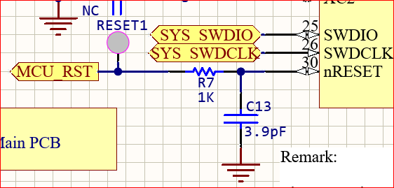

Hi  Support Team

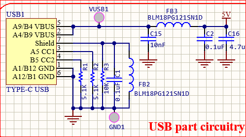

Our product have a CD 4kv and AD 8kv ESD test, but the samples reset on AD 8kv close to the USB, the reset register show it is nRESET PIN reset.

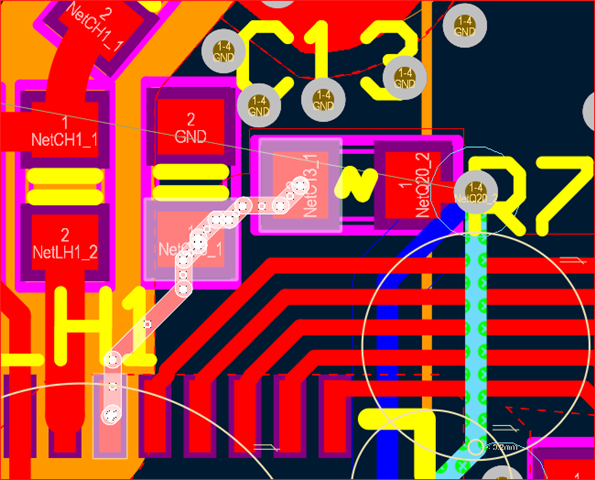

add an ESD diode to this pin, no any improving. removed C13 and R7, the ESD is improved, but still have chance to be failed.
Is only nRESET PIN can trigger thise reset? Any suggest from your side, we can offer SCH and PCB file if you need.
